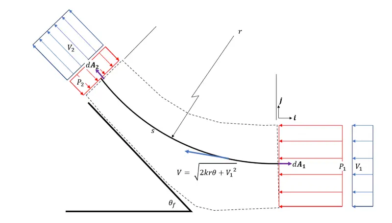

Arjan82 said:
I'm wondering which equations you are solving, since they look different in a non-inertial frame of reference.
Let me just start with Mass - Continuity for the cart, incompressible flow: The control volume is moving to the right with ##v \boldsymbol{i}## at any particular instsant and the cart is accelerating to the right:
So, continuity for the flow inside/passing through the control volume is given by:
$$ 0 = \frac{d}{dt} \int_{cv} \rho d V\llap{-} + \int_{cs} \rho ( \boldsymbol{V} \cdot d \boldsymbol{A} ) $$
Density ## \rho## constant in throughout flow spatially and in time. As well as control volume not deforming in time.
$$ \implies 0 = \cancel{ \frac{d}{dt} \int_{cv} \rho d V\llap{-}}^{0} + \int_{cs} \rho ( \boldsymbol{V} \cdot d \boldsymbol{A} ) $$
## \boldsymbol V ## is the velocity of the flow relative to the control surface at stations 1 and 2 , with uniform velocity distribution:
$$ 0 = (\boldsymbol {V_1} \cdot d {A_1}) + (\boldsymbol {V_2} \cdot d {A_2}) $$
$$ 0= \langle -V_1\boldsymbol {i} \rangle \cdot \langle A_1 \boldsymbol {i} \rangle + \langle -V_2 \cos \theta \boldsymbol {i} + V_2 \sin \theta \boldsymbol {j} \rangle \cdot \langle A_2 \boldsymbol {j} \rangle $$
$$ V_1 A_1 = V_2 A_2 \sin \theta $$
My first concern.
Is it ok to assume ##A_1## and ##A_2## are related geometrically:
Hence ##V_2 = V_1 \tan \theta##
or are the required to be related through The First Law? I want to see if I have this step under control before moving forward. Thanks for any help.

  • #168
This is incorrect.
First of all, there is a difference between ##-V_1## and ##V_1 < 0##. The first means that somewhere in your analysis you need the negative ##V_1##, the second means that ##V_1## has a negative value. However, in the analysis, it doesn't yet matter which values, positive or negative, the symbols have. That only comes when you are computing the numerical values, at the end of the analysis.
You are also confusing the vector ##\boldsymbol{V_1}## with the component of the vector ##V_1##. So, both vectors ##\boldsymbol{V_1}## and ##\boldsymbol{V_2}## have two components. I presume that with ##V_1## you mean the first component of the vector ##\boldsymbol{V_1}##, but what is then the first component of ##\boldsymbol{V_2}## called? It is probably better to adopt a notation like ##\boldsymbol{V_1} = [v_{1i}, v_{1j}]## and ##\boldsymbol{V_2} = [v_{2i}, v_{2j}]##.
Third, ##\boldsymbol V_2## nor ##\boldsymbol A_2## have anything to do with ##\theta##. The surface ##A_2## has no angle ##\theta## in it.
So the equation should be:
\langle0\rangle = \langle v_{1i} \text{, } v_{1j}\rangle \cdot \langle a_{1i} \text{, } a_{1j}\rangle + \langle v_{2i} \text{, } v_{2j}\rangle \cdot \langle a_{2i} \text{, } a_{2j}\rangle
This is also wrong. It will become
v_{1i} a_{1i} = v_{2j} a_{2j}
This makes use of the fact that ##v_{1j}##, ##v_{2i}##, ##a_{1j}## and ##a_{2i}## are all zero (the way you've drawn it).
Is the drawing meant to be 3D? Otherwise I don't understand it. But you can define the control volume anyway you want, they're not bounded by any law other than that the geometry has to make sense (not self intersecting and all that). In the way you draw them they are indeed geometrically related.

Coordinate acceleration is dv/dt relative to some frame, so it's frame dependent. Coordinate acceleration equals proper acceleration in free falling frames.
  • #170
user079622 said:
But that I say in post #158 and #160. So what I said wrong?
What you say in post #158 and #160 is indeed wrong, it is not equal to what I said... Unless you are trying to analyze a rocket that is not accelerating but the air around it is accelerating.
  • #171
Arjan82 said:
This is incorrect.
$$ \boldsymbol{V_1} = V_1 \langle -1\boldsymbol{i} + 0\boldsymbol{j}\rangle $$
The un-bolded ##V_1## is a magnitude. I omitted the "0j" in the vector ## \boldsymbol{V_1}##, because in the dot product it vanishes anyhow.
Same thing with the areas bolded is vector, unbolded magnitude ## d \boldsymbol{A_1} = dA_1 \langle 1\boldsymbol{i} + 0\boldsymbol{j} \rangle ##
As far as ## \boldsymbol{V_2}## goes, I try to assume that the streamlines exiting the control volume at 2 are parallel to the face of the cart. hense:
## \boldsymbol{V_2} = V_2 \langle - \cos \theta\boldsymbol{i} + \sin \theta \boldsymbol{j}\rangle ##
Likewise ## d \boldsymbol{A_2} = dA_2 \langle 0\boldsymbol{i} + 1\boldsymbol{j} \rangle ##
Again, omitting components that vanish in the dot product. It was very half arsed, sorry if that was confusing.
I'm trying to represent that the "flow" over the inclined surface is uniformly distributed along an axis coming into/out of the page.
  • #172
