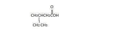

I am attempting to draw 3-ethylbutanoic acid as well I am trying to determine the geometry of (FeCl4)- and (Ni(CN)4)-2.
Also, can dichlorobisethylenediaminecobalt(III) chloride be expressed as (Coen2Cl2)Cl?
I think 3-ethylbutanoic acid can look like see attached
Just for clarification a double bond is coming off of the C=O and a single bond off the C-CH2CH3
I believe the geometry of (FeCl4)- is Tetrahedral and the last one is square planar
  • Skeletal structure drawn as text: CH3CHCH2COOH with a CH2CH3 branch hanging below the second carbon, showing a proposed 3-ethylbutanoic acid chain with a C=O double bond.
Check your compound. If you follow IUPAC naming rules, 3-ethylbutanoic acid does not exist.
