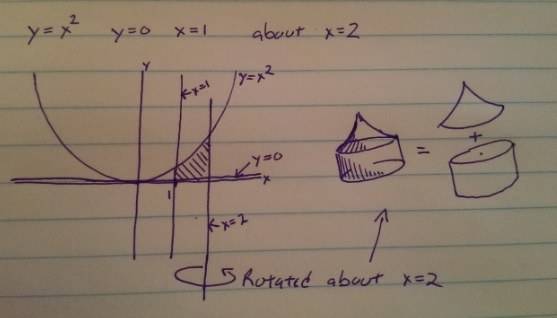

emk
Y=x^2, y=0, x=1 ; about x=2
v=pi r^2 T
I tried 0 to 1 intg (x^3-2)^2+2^2 dx, but it wasn't right. Not sure what to do.

It may help to break that thing up into two different integrals. The thing is shaped like a circus tent. That is, a cylinder with a spire on top. The cylinder integration can be done without calculus. Then do the spire part using your books formula (the formula for volume basically) and add the two.

I see no spire on top, just an oddly-shaped cylinder.

QuarkCharmer's description makes sense to me. The point of the spire is at x=2, the axis of revolution. But the washer method just seems to complicate matters. emk, were you told to use that method here?
Yes, either the disk or washer method.
