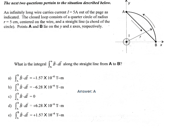

Please check attachment or picture below.
http://i.imgur.com/PIwt0.png
Since there is no enclosed current for path AB, shouldn't it just be 0?
Thanks!
Thanks!
The question does not ask for the integral around the closed path.
