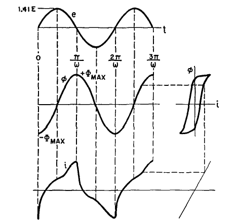

The reason why I was asking:
That's the plot of a coil with a Sin voltage source exciting a core with hysteresis loss.
I was utterly lost when voltage and ø are Sinusoidal but the current's shape is screwed up. shouldn't voltage drives a sinusoidal current and that current will result in a screwed up shape of ø?
or at least: I know the L of the coil will be changing as well, so current shouldn't be really sinusoidal. But NI is the MMF, and to me that's a "fundamental driver". There is absolute no reason for a voltage on a coil to induce a perfectly shaped sinusoidal flux.

That's the plot of a coil with a Sin voltage source exciting a core with hysteresis loss...
There's a mathematical reason... and it's shown on your graph.
remember e= n d[itex]\Phi[/itex]/dt ? Voltage(per turn) is rate of change of flux?
Now remember your trig identities
d sin(ωt) = ωcos(ωt)
Now - do a sine and cosine wave resemble one another? Sure, they're just 90 degrees out of phase.
Next - do your voltage and flux waves resemble one another? Sure, they're just 90 degrees out of phase.
Try exciting your inductor with a small square wave voltage. You'll see a triangle wave flux, because during each half cycle d[itex]\Phi[/itex]/dt is constant.
If you force a triangle wave current through an inductor your voltage will resemble a square wave. That is a great way to observe the imperfections of an iron core. Eddy currents that limit frequency response show up as rounded edges.

Now - since current is mmf, as you said,
and it takes more mmf to increase flux on those flat parts at extremes of your B-H (phi-I) curve,
that's why current deviates from sine.
It's counterintuitive because flux is greatest at voltage sinewave zero crossings.
Think derivatives, think slopes.
old jim

Your example imposed a sine voltage on the coil
If instead you forced cosine current through your iron-cored coil
your flux wave would be flattened near its peaks, again because of iron's nonlinearity.
So the voltage 'sine' wave would be deformed around its zero crossings.
Air core inductors are better behaved. Those twelve foot coils behaved just like textbook inductors until we inserted the core..
