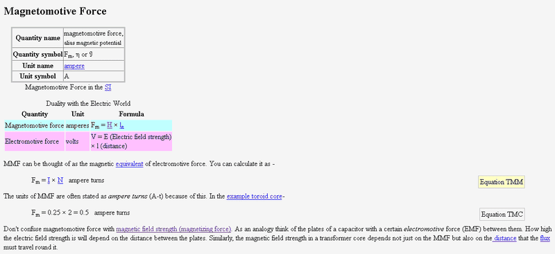

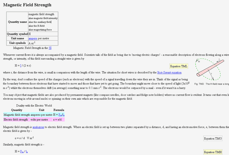

MMF is amp - turns. In the text from which fig 2 comes he calls it 'current linkages' Θ . see .https://www.physicsforums.com/attachments/current-linkage-ask-pdf.208916/
H is MMF per unit length
http://info.ee.surrey.ac.uk/Workshop/advice/coils/terms.html#strength
Walking around your red amperian loop and crossing the air gap anywhere on the pole face you'll enclose the same amp turns. None of them get expended in the iron, that's stated in the text as a simplifying assumption..
So mmf, amp-turns, is the same along a path that crosses the air gap anyplace on the pole piece.
But - the paths nearest the center traverse the shortest length of (almost non-permeable) air so MMF/Length, which is H, is highest there.
They shape the pole piece to make an air gap that results in cosine shaped flux.
Remember B = μμ0NI/Length where NI is MMF, NI/Length is H
giving the more familiar B = μH Same reference :

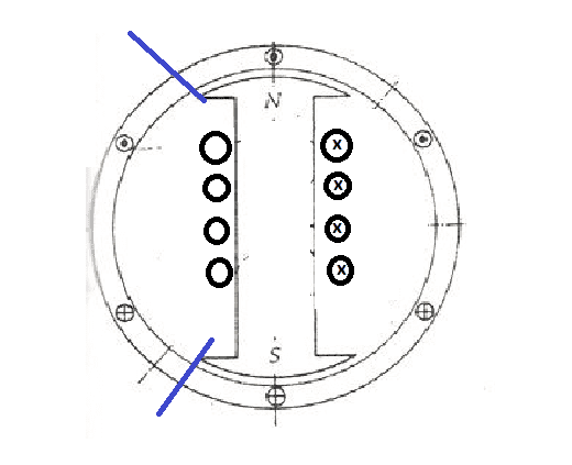

Hi and thank you for the replies, I appreciate that you take the time and effort to help a newbie like me.
My first misconception was that I thought MMF was equal to H, but of course it is not, I could have seen that from Ampere's law even.
My second misconception (I think) was that my mental picture of MMF was field lines similar to the field lines of a magnet.
I think I am close to understanding this. I think I understand why the MMF is constant along the pole shoe as jim hardy said:
What remains for me is: How can I draw the MMF distribution from North-pole to south-pole (between the blue lines, see figure in next post), what happens with the MMF distribution when I leave the surface of the pole shoe and how will I draw the ampere loop to describe this?

@EEstudent90 One thing that can be helpful in understanding these magnetic solutions with ## \oint H \cdot dl=NI ## is that because ## \nabla \cdot B =0 ##, flux lines of the magnetic field ## B ## are continuous. Meanwhile ## H ## changes as you enter different materials, and to a first approximation can be considered constant throughout a given material because ## B=\mu H ## is continuous, and ## H ## doesn't change much until ## \mu ## changes. Meanwhile, in magnetic materials, ## \mu ## is very large, making ## H ## very small, while ## B ## remains nearly the same as it goes from one material to the next.

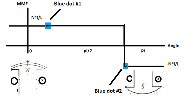

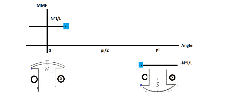

Again thanks. I am very very close to understanding this, but I still have to understand how the MMF (NI/L) is distributed after we leave the pole shoe.Please take a look at my crappy paint drawing below. I have tried to draw the MMF distribution across the air gap as a function of angle, where I start at the middle of top pole shoe. I don't understand how the distribution will be between the blue dots, and have therefore not drawn anything after I leave the pole-shoe, shown in the paint drawing below.
How can I draw my ampere loop on the picture below, to show how the MMF distribution is between the blue dots in my first paint drawing?
Sorry if you have explained this question I ask in this post already, but if that is the case I have not understood it.

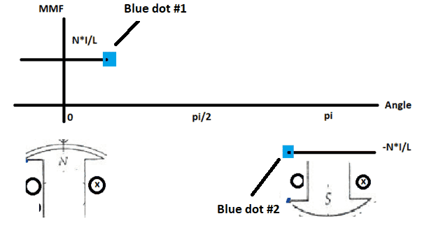

i only see one blue dot - were's the 'between' ?

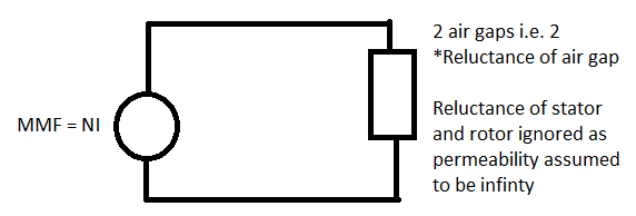

Maybe it'll help to apply the same mental trick we use for electric circuits.Imagine yourself very small sitting in the air gap on that pole piece right in its middle
Think dirt simple in baby steps...
(excuse MY crummy Paint sketch)
Looking horizontal you see the lines of flux streaming up out of the pole. Note they take a path resembling an Amperian loop - after all it's amp-turns that are making the flux flow...
Looking down with X-Ray vision you see the amp-turns encircling the rotor. They make MMF equal to NI pushing flux UPward.
Right in the middle you take your "Acme Portable Gauss Meter"* and you measure flux density equal to μ0NI/Length where 'Length' is the distance from pole piece to stator at point of measurement. Note we're measuring flux density , not flux...
Now you move over a few millimeters and repeat your flux density measurement.
This time Length is different . SO Flux will be μ0NI/(new Length) , different from before.
So the same MMF (NI) applied to a different distancegives different H(NI/Length)
For the example in that textbook , the one that started all this,
It is incumbent on the machinist who fabricates that rotor pole piece to shape it such that Length(of air gap) is cosine( angle).
Note that MMF is constant across the pole but H is not.
See if your equations follow naturally from that thought process ?

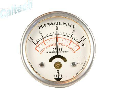

'Gauss Meter' is not a figment of my imagination
i found one of these in a junkshop . Had to give ten bucks, though .
I love it. Handy for checking if car alternator is charging the battery .

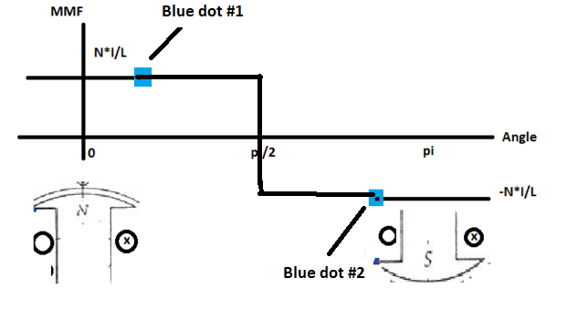

Jim hardy post#15: Now you move over a few millimeters and repeat your flux density measurement. This time Length is different . SO Flux will be μ0NI/(new Length) , different from before. So the same MMF (NI) applied to a different distancegives different H(NI/Length)
Maybe I have stated my question a bit poorly, but my problem is how the distribution of the MMF will look like between the blue dots in my paint drawing. Below are two examples.Look like this?
Or like this?
How can I decide how the MMF distribution will be (picture 1 or picture 2, if any) using Ampere's law or something similar?
The MMF comes from the number of turns and the current and runs upward through the iron core surrounded by the current windings. ## MMF=NI ##. The magnetic "voltage drops" occur across the air gaps and the resistance is proportional to the distance. The "magnetic voltage drop" is measured by ## \int H \cdot dl ## across the gap. ## \\ ## Meanwhile ## \int H \cdot dl ## is very near zero in the magnetic material, because ## H ## is small in the magnetic material. (If ## B ## is finite and ## \mu ## is very large, that makes ## H=\frac{B}{\mu} ## very small). ## \\ ## The ## H_{gaps} ## can be computed because ## \int H_{gaps} \cdot dl= H_{gaps}L_{gaps}=NI ##. Then the magnetic field ## B ## can be computed: ## B_{gaps}=\mu_o H_{gaps} \approx B_{everywhere} ##. (This last "approximate" expression is just an approximation to illustrate a concept. The flux lines of ## B ## are continuous so if the flux lines spread out ## B ## will of course decrease.) ## \\ ## And to explain your question in the post above-the MMF is similar to an electrical battery or EMF being in the circuit. The voltage increases in going through the battery. Just like in a floating electrical circuit, the exact location of the ground is really arbitrary. The upper shoe has a "magnetic voltage" that is ## NI ## higher than the lower shoe.

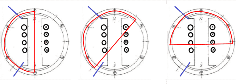

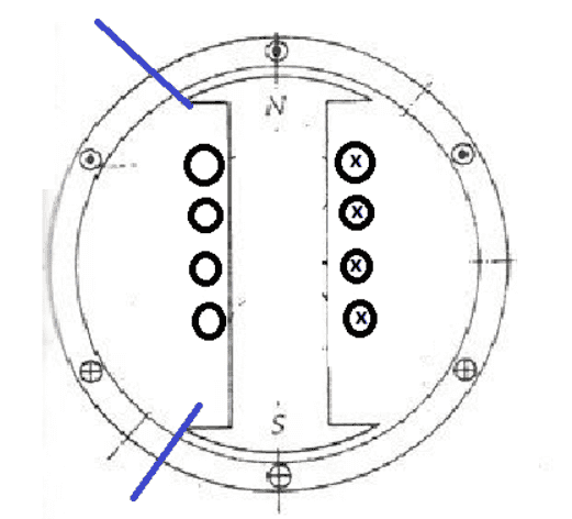

Ok I think I got it, please see if what I write makes any sense, @Charles Link and @jim hardy
Below I have drawn three scenarios.
Scenario 1 (left):
MMF across airgap is at its maximum as maximum of net current enclosed by my Ampereian loop is maximum.
Scenario 2 (middle):
MMF is lower across the air gap where my Amperian loop is crossing, because net current enclosed is less as we have included another conductor, but this one is in opposite direction and therefore subtract and not add.
Scenario 3 (right):
MMF is zero across the air gap where my Amperian loop is crossing, because net current enclosed is now zero (equal amount of current going into and out of my surface enclosed by my Amperian loop.
@EEstudent90 I think you got it ! :) I am finding this, including your latest post, very educational, because, unlike @jim hardy , I haven't had much previous experience in working problems involving the MMF. :)

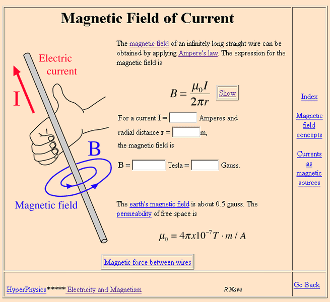

To get the MMF at some point outside the solenoid we could use another form of Ampere's law
http://hyperphysics.phy-astr.gsu.edu/hbase/magnetic/magcur.html
(which is a kissing cousin to something known as Biot-Savart law)
It gives you a magnitude but not a direction.
Since in air B = μH and we're in air we can write μ0H = μ0HI/2πr
divide both sides by μ0 and you're left with H = I/2πr where r is distance from a wire.
But you have to figure out the direction from geometry.
I'm not sure you can.
Sorry i didn't have a good answer yesterday - i struggle for words and it sometimes takes days to find them.
Now since the purple flux is so much larger than that taking the red or green path we can ignore them.
But it's interesting academic exercise to calculate the mmf out there.
I still think it'd be a summation of individual mmf from each wire
or from each turn as in that first paper.
Note as observer's distance from solenoid increases, the distance from opposite sides becomes more nearly the same so the red and green mmf's cancel more and more. So MMF and flux outside drops rapidly .as one moves away from the solenoid.
Correct me if my thinking is not straight.
old jim
