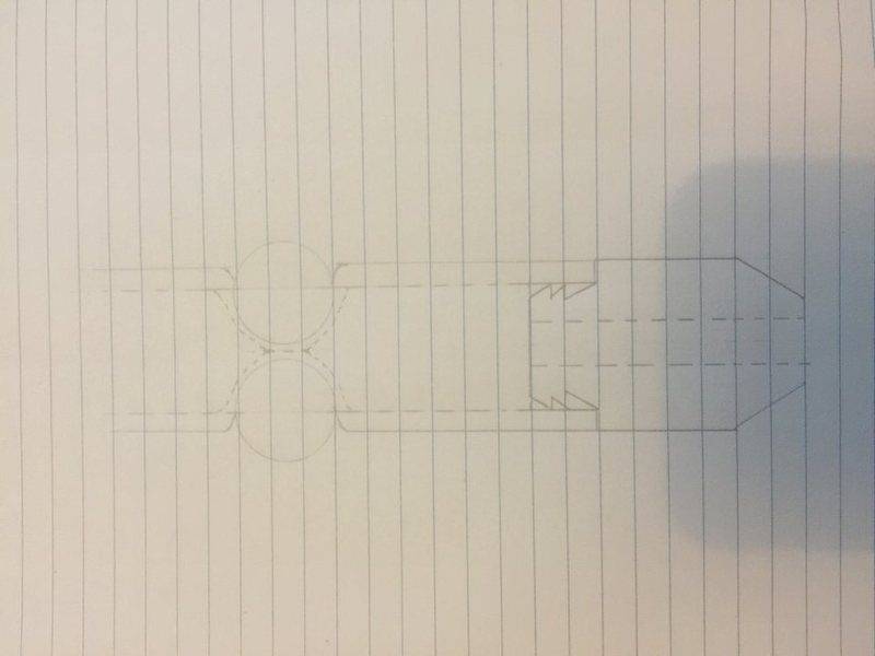

Hi all,
I'm new to the forum and was after a bit of guidance.
At work we are looking into purchasing a new dosing unit, however I'm unsure if the design that has been drawn up is going to work.
The units design revolves around the principle that a flexible tube is compressed closed by rollers actuating against the tube.
The rollers are set below the tube offset below the tube and when actuated close parallel to each other completely closing the tube.
My question is would those rollers coming together create a backwards pressure? If so how would I calculate it?
Some of the product will be left below the rollers in the flexible tubing with no valve stopping it from dripping, so if there is backwards pressure, for the product not to drip the pressure must be greater than the specific gravity of the product? Is that correct?
If a drawing is needed to further illustrate the question I can drawn something up.
Thanks

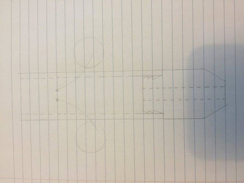

I quite possibly didn't explain myself very well so I have drawn it up.
Would the roller rotating upwards and closing the pipe work create a backwards pressure to hold the product below the rollers within the nozzle with enough force to stop that product dripping out? There is no mechanical valve to stop the product dropping it's just a straight through hole. The nozzle isn't submerged in product so Air can travel freely into the pipework when the rollers actuate to clea the pipe.

Yep, it works (the uploading). Back- and forward presssure seem unavoidable when the roller comes down, even when it's moving to the left. But I 'm not sure I have your question the right way: are you worried about dripping on the right (supply side -- in my view connected to a reservoir or something) or about dripping on the delivery side (the left if I am not mistaken) ?
This delivery side should be less of a problem, since when the rollers separate again, the same phenomoenon occurs in the other direction: a small underpressure when the tube reassumes its normal volume.
For some reason it has flipped the photo while uploading the left side is the sump side, this is not left to right but actually top to bottom.
Left side is where the product is delivered to via a servo drive so an exact cc is delivered. The PLC then triggers the rollers to actuate and close.
What I'm trying to calculate is when the rollers close will the pressure caused by the pipe being blocked stop the product which is already below the rollers and in the nozzle from dripping?
Basically I need to calculate the back pressure from the rollers closing then use that against the specific gravity of the product to find out what size opening that should be used on the nozzle at the end of the pipe?
Does that sound possible?
Thanks
Ok, so feed is from left in the picture as it appears on my screen now. Dosage stops and probably blocks backflow to the left. Any volume reduction of the tube necessarily pushes product to the right. Gravity is one thing, viscosity the other.
What I don't understand is the logic: if the dosage pump stops, why bother to use these rollers ? Afraid air is leaking in ? If so, what's the fundamental change between the two pictures that would prevent such a mishap ?

The reason for the rollers is that there are four of these dosing units fed from a manifold which is higher than the dosing units. Although there is no applied pressure from the pump on the product it seemed to drip out more freely due to the amount of product in the pipeline going back to the manifold.
The initial idea of the rollers was based around the principle of holding water in a straw when you keep your thumb on the top end.
We have done a few simulation trials and it's a bit hit and miss. If the nozzle size is too small it sprays the product out all over the place but the product doesn't drip. If the nozzle size is too large it drips out.
The issue is we run multiple products through this and the specific gravity can change between batches of the same product let alone product changes.

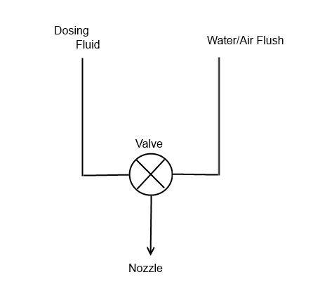

Why use rollers to pinch the pipe rather than a regular lever valve?
How about using a valve arrangement that shuts off the fluid and expels any remaining fluid below the valve using compressed air or water?

The issue is we are dosing 200 bottles of product per min of varying specific gravity and weights. We have tried a wide array of mechanical valves yet nothing can keep up or doesn't drastically wear over a short period.
When the nozzle size is correct to the product there are no leaks. It's just establishing the correct nozzle size to the product batch as there are slight variations between batches causing the same nozzle to drip or even leak.
Those 200 bottles per min is shared between 4 nozzles so each nozzle operates 50 times a min
So the rollers will be compressing the pipe 200 times a min? Will the pipes stand up to that?
The pipework does need to be changed every few days but the cost and time of swapping a pipe out against a PLC controlled festo solenoid valve. The pipework can also be changed when each product is swapped out and then cleaned out when the nozzle is changed.
