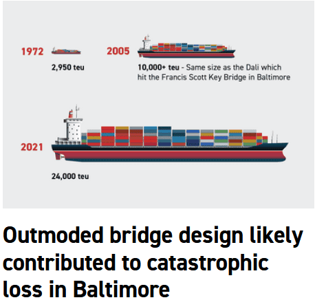

Filip Larsen said:
As I understand it, this is a fairly common and well-known option for collision protection on (newer) bridges, so do anyone know the specific reason why that protection was not selected for this bridge?
Old bridge, old standards for (lot) smaller ships of old times?
  • #35
There is of course an age aspect of that question, but it was constructed around 1972 so not all boats were small at that time, and establishing protective zones is something I would imagine can be added or augmented long after a bridge has been constructed so I would guess there are other more compelling reasons it was not done. I was thinking possibly candidate reasons could be cost (always a factor one way or the other), environmental impact (although that is a much newer concern, but one that is addressed quite often now when marine constructions are proposed in the area I live) or perhaps the tides in the bay would wreck havoc on any attempt to raise the seabed?
The reason I ask is because I am just curious, but I foresee this question quickly becoming relevant when a new bridge has to be constructed, as it likely comes with a requirement that collapse from potential collisions must now be extremely unlikely.

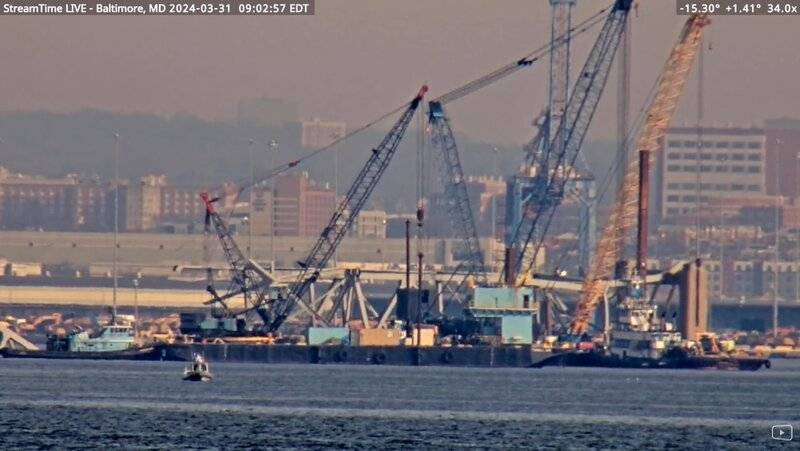

During last evening's news, there already was a large, floating crane at the site. NTSB still has to approve any removal once they've done their initial investigation but they clearly aren't going to waste any time with the removal process once they're cleared to do so.
However, this morning I don't see anything other than small patrol boats on the current Real Time Ship Tracking. Hmmm, maybe I saw one of the gantry cranes in the background. I could have sworn there was one in the water though.
  • #40
Live stream of the harbor on YouTube..
