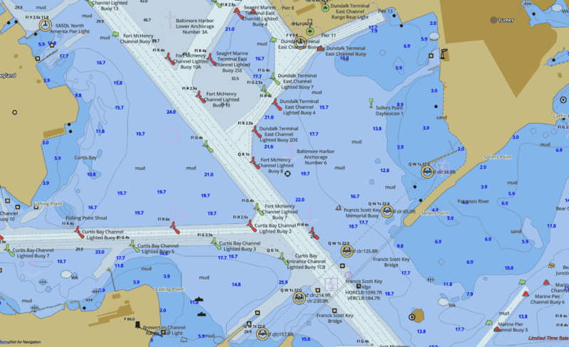

  • #119
gleem said:
One other thing, the ship was traveling down the channel(rudder amidship) when the power was lost so I do not think the ship should have turned too much based on that. Dropping the port anchor should not have caused it to veer toward the support. However, the ship makes a relatively sharp turn toward the bridge support prior to inpact.
I heard on one video that the black smoke, ostensibly from the main engine restart was blowing/flowing laterally indicating a breeze from the port side, which would have pushed the DALI to starboard. I heard a conflicting comment that there was no breeze that evening.
In another video, someone mentioned a channel to the starboard side of the DALI, from which a current may have pushed the stern to port reorienting the ship toward starboard. The Curtis Bay Channel comes from the west to join the Fort McHenry Channel, which goes from NW to SE and is centered on the main span of the Francis Scott Key Bridge. Ostensibly, a current flow east in the Curtis Bay Channel may push the stern of the ship and be enough to turn the ship if it has no rudder control (rudder is stuck amidship).
https://fishing-app.gpsnauticalchar...ORE+HARBOR+boating+app#14.23/39.2192/-76.5270
I also heard some discussion with engineers that the bridge had less protection than others. So, the lesson here is that the bridge piers needed much better protection.
https://www.reuters.com/world/us/ba...need-protect-critical-foundations-2024-03-28/
As for the ship, the lesson learned here is that such ships need to have independent systems to ensure navigation/steering/rudder control in the event that the main power plant (or whatever systems provides power to the navigation/steering system) shuts down.

  • #120
There is a lot of ship underwater to resist such a motion and it would take a substantial wind to move the ship a significant amount in 4 min. Also typically a night the wind is usually light, especially in a harbor.
About current I doubt there is a significant cross-current in the channel since in a narrow harbor the tides would be basically flowing out of the harbor. The current in the channel would be lower than that near shore due to depth. The video I saw showed the ship distinctly turning not drifting toward the bridge. I don't think a difference in the speed of the current would significantly change in the length of the ship unless it was a huge CW vortex near the bridge but such a vortex would have moved the bow to port first before causing it to turn to starboard.
If the black smoke was of the engine going in full astern then that would have caused the ship to turn to starboard toward the bridge support. If the ship had it GPS nav equipment running we have a record of the track of the vessel. We'll eventually find out.
Another question I have is do they have a battery backup for certain equipment like nav or deck lights that you don't want to go out.
