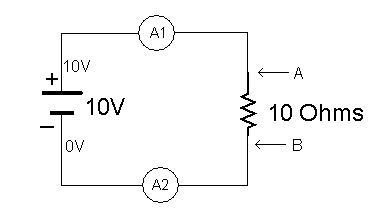

Russell Ensslin
What is the neutral wire? Why do we need that?
Neutral wire provide a path for a returning current to the "source" (neutral is a wire that carrying the full load current).
Thank you for your response.

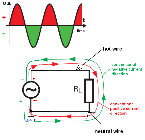

Some you tube videos say alternating current changes directions frequently. Does it change back and fourth through the two hot wires? why doesn't the neutral cause a short? Other sources say high-tension lines can overbuild up too much charge causing risk of "static" discharge; would this be a short? or Ground?
Hello Russel and Welcome - I disagree a little with Jony, the Neutral wire does provide a path back to the source, but does not necessarily carry the full load current. Think of the the Neutral as a Neutral point in the system. In most (not all) systems the neutral is grounded near the source. This allows for a path of current back to the source, but keeps the ground out of the normal path - there are many reasons for this being beneficial.
And yes - Alternating Current "alternates" direction but this is both current and voltage - So power can be delivered TO the load with the current flowing in both directions - this is represented in P = V * I .
So a load can be load can be connected between a "hot" leg and the neutral - the current then flows through the load and the neutral. But you would not connect the Neutral to the Hot leg - this would cause a short - the idea is to deliver energy to a load.

As for the AC current we simply measure all the voltage with respect to the neutral wire (neutral wire is our reference point).
And this means that
meBigGuy said:
The current flows out of HOT and into NEUTRAL (through the load) while the voltage on HOT is POSITIVE. When the voltage on HOT momentarily goes to zero there is no current flow. Then, when the voltage on HOT goes negative the current flows out of NEUTRAL and into HOT (through the load). The current can flow into or out of NEUTRAL (through the load) depending on whether HOT is positive or negative voltage. The current can flow in either direction through the load. In almost all cases it doesn't matter to the load which way the current flows, which is why it can accept AC voltage directly, like a toaster or a filament light bulb. (we will skip the exceptions for now).

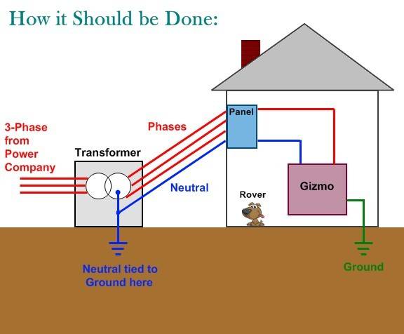

If the neutral connects to the ground then why not ground it at the device? Why carry the load back to supply after the application if it's going to be grounded before it gets back to the transformer?
because you DONT want the metal chassis to be part of the AC circuit
the separate Earth connection gives a safety factor, if the phase/live becomes dislodged and touches the chassis, there will be an instant fuse blow back at the power panel

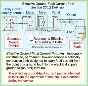

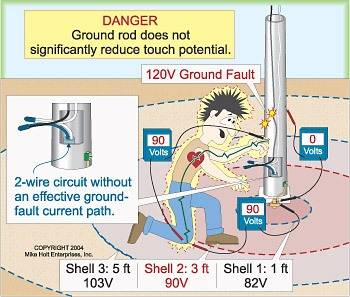

Yes. This is correct. I just wanted to post a couple of my favorite images from http://ecmweb.com/bonding-amp-grounding/grounding-vs-bonding-part-1-12
This one shows the currents path of a fault through the safety ground.
This one shows the "touch potential" due to an inadequate ground.

Thanks for the image dlgoff. I have one question. Current always flows through least resistive path. So in the first image, if we look to the left, then at the secondary of the transformer why does current flow X1---meter---main---panel---outlet---load---X0 instead of X1---X0---ground, since X0 is grounded?
J-T -- the current needs to flow in a loop. If it goes X1 - X0 - Ground- then to where? -- Be careful with the thought "Current always flows through least restive path." - this can be misleading thinking that ALL of the current flows in the least restive path; when we have 2 or more paths the current will divide and the least restive will carry more current than the higher restive path.
Russel - the Neutral is part of the circuit normally, it is A (as opposed to the only) return path to the source. The process of grounding ( earthing) is primarily for safety, but has other benefits when well applied, such as affecting power quality, noise, etc.

Thanks for the X1 to X0 to Ground then where? That what i was thinking while posting what i said. But then what happens in case of fault? Like when lightning strikes or in case of insulation failure of appliance where current leaks to the appliance body and could give the user a shock if the appliance isn't grounded.
Like the current indicated by green arrow in the diagram. That current goes to ground but doesn't return to the appliance from where it is leaking.

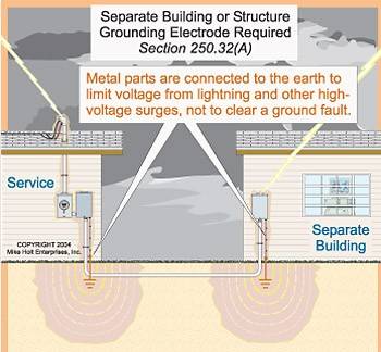

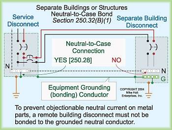

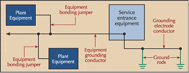

You are asking a very important question here. You should go through all of the Grounding vs Bonding parts. I'll provide some quotes, followed by images, that I consider high points from those parts.
The Earth's resistance is too great for it to be an effective bonding jumper. Very little fault current returns to the power source winding if the Earth is the only fault-current return path. ...
Properly grounding and bonding service equipment improves safety while eliminating a common cause of power quality problems. You just have to make the right connections in the right places. If you think in terms of providing a low-impedance ground-fault path back to the source, you'll have no problem.
The benefits of proper bonding include clearing faults, preventing shock, and reducing fires. Grounding provides a low-impedance path for lighting, and properly grounded systems operate as intended. Improperly grounded systems create fertile ground for power quality problems.
The preferred practice is to not use the grounded conductor (neutral) as the effective ground-fault current path. Instead, you should install an equipment grounding (bonding) conductor with the feeder conductors to the building or structure ...
... electrons that leave a power supply are trying to get back to their source, not back to the earth. However, lightning is trying to get to earth.
this quote and image is from http://ecmweb.com/content/earth-not-bonding-jumper
... bonding jumpers tie the grounding system together through a reliable low-impedance path.
I hope this will give you an idea of the considerations. That's why there are electrical codes ... to minimize risks.

What is X1? X0? Is there an image somewhere?
I was responding to J-T (p15) asking about the top image in P14
I was asking regarding this image: like in case of fault at the load end(extreme right side) the fault current(green line) flows from appliance to outlet to panel to main to meter to X0 and then to ground
Why does this not happen in normal working case like: X1 to X0 to ground or X2 to X0 to ground.
