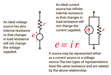

What you can do is convert this voltage source and that series resistor into current source and resistor in parallel.
And then you are free to do whatever you want with your resistors, because they are free of any sources directly connected to them.

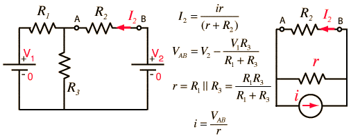

If you use Norton's theorem to work a two loop problem, you can parallel R1 and R3 in order find an equivalent resistance r as shown here:
For other methods to analyze two loop d.c. circuits, follow this link.
http://hyperphysics.phy-astr.gsu.edu/hbase/electric/dcex.html#c2"
Thanks, but Norton theorem is beyond the scope of my studies as far as I know. Thanks as well Bass, ILS. :smile:
