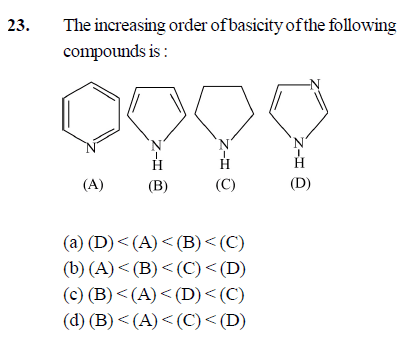

the increasing order of the basicity of the following
compounds : (Please check the image I have attached for the options )
I don't know any
I think the correct ans should be c (i.e C>D>A>B ) but its given d in my textbook( There can be a error also but I'm sure)
I think C should have the highest basic strength since Hybridisation of N in this is Sp3 so it has the least electronegativity so it can donate its lone pair easily
Then it should be D since there are two N atoms of which one's lone pair is in conjugation and one has a lone pair not in conjugation so it can donate that lone pair
Then A because it has only One N atom of whose lone pair is not in the conjugation. So it can donate it. And B last because the lone of N atom here is involved in the Aromaticity of the compound so it would be very difficult for it to donate that lone pair
Plz, can someone tell me if my reasoning is correct?
I agree with your reasoning, and having looked it up I think you're right. Textbooks can make mistakes sometimes!
Likes SpectraPhy09
Yes I think you could say that the neutral form of D (Imidazole) Is resonance stabilised, and the protonated form not. The pKa of its conjugate acid is 6.95 whereas that of C (Pyrrolidine, you could call it cyclic butylamine) is 11.3.
It's just a secondary amine, which made me think of comparing with diethylamine. pKa of c.a. 10.54. Then I thought, assuming the difference of that with pyrrolidine is significant enough to compare, how rationalise?At first I thought solvent accessibility but predicted the wrong way round, but then I thought no, the cyclic structure can't so easily form a hydrocarbon ball as the diethyl. These amine basicities have the property that you can always rationalise them.
