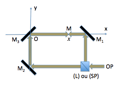

Beam splitter with single photons
When a single photon hits a 50-50 beam splitter, it does not split itself but rather exhibits wave-like behavior, leading to the possibility of being detected in either output path. The interaction can be understood through the principles of quantum mechanics, where the photon behaves as a wave, creating interference patterns. At point x, the probability of detecting the photon depends on the superposition of the wave functions from both paths. The concept of standing waves may apply, but it is essential to consider the quantum nature of the photon rather than purely classical wave properties. Understanding these principles is crucial for analyzing photon behavior in quantum optics experiments.
physmatics
So we have a source (OP) that emits single photons of a constant wavelength and angular frequency. The photons hit a 50-50 beam splitter, and are then reflected in the mirrors. Where is says (L) ou (SP) (yay for studying in French!) there is a beam splitter.
What I want to know basically is what happens. What happens when the photon hits the beam splitter? What happens at point x, and what is the probability of detecting a photon there?
I think it will become a standing wave, but how does that work with only one photon? Does the photon split itself when traversing the beam splitter? What happens in that case when the two waves meet at the point x, and what is the probability of detecting a photon there?
I would be more than happy if anyone could answer this, as I haven't been able to found a similar problem anywhere and my professor refuses to answer e-mails.
Thank you so so much!
And I am sorry that this is a repost, but I would very much like to have an answer!
Here is my thoughts that might be wrong but...
Perhaps in this example, you should consider using the wave properties of light rather than the quantum properties. I can't imagine a photon splitting but I can imagine the wave splitting and I would agree that there sould be a standing wave pattern at x. Just my thoughts and they may be wrong.
