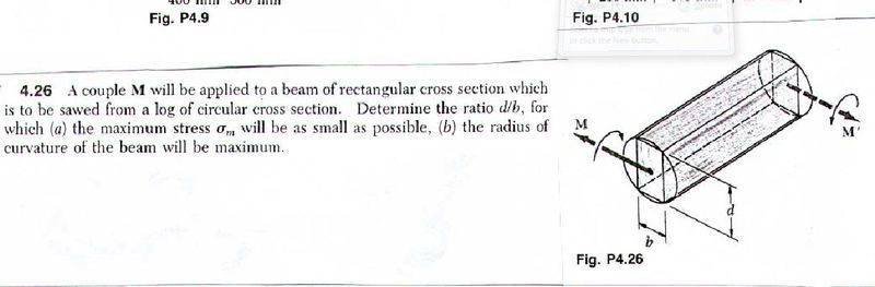

find the ratio of d/b such that the largest stress in the beam will be minimum
i know that the maximum stress is
σmax=Ymax[tex]\frac{M}{I}[/tex]
and i know that for a rectangle I=bh3/12
now in the question i am asked to find the ration of the (diameter of the log)/(the width of the rectangle) such that σmax is minimal
since the rectangle is contained in the circle
d2=b2+h2
where h is the height of the rectangle
σmax=(h/2)*(12M/(bh2)
σmax=6M/(b*h2)
σmax=6M/(b*(d2-b2)
basically from here i need to find the ratio d/b so that (b*(d2-b2) is maximum,
but how can i do this??
d/b=K
(b*(d2-b2)
=(bd2-b3)
=d/b*(d*b2-b4/d)
but i can't get to the ratio, i feel i am so close but just not getting it
That is not shear stress. Your comment does not make sense. [EDIT: OK, you edited your post in response to my comment, without letting anyone know, thereby making my above comment appear as nonsense.]
You seem to not understand what d is, as if you have not looked at the diagram.
at first i thought that d was the height of the rectangle, but thatdidnt make sense to me, if that is so what is the circular log given for?? it is not 100% clear to me in the diagram what they mean by d.
as far as i know that is the equation for stress,
how would you have gone about solving it??
Use a straightedge to see what d is.
so you say that d is the height of the beam, if so why do they need to tell me that the beam is taken from a log,
if i take the height as d
I=bd3/12
σmax=(h/2)*(12M/(bd3)
σmax=6M/(b*d2)
now i need b*d2 to be maximum
but i still can't get to the ratio??
i supose that b*d2 will be maximum when d/b-->infinity
but that doesn't seem right at all
never mind, i think i got it
b2+d2=D2
i differentiate the stress equation adn compare to 0 and i get sqrt(2)
They don't tell you the size of the log, but the ratio r= d/b is constrained by the circular boundary. In my experience, if a problem says to find a ratio, then the first line should be: Let r be the ratio. Then work everything towards equations in r.
thanks but i got it already sqrt(2)
