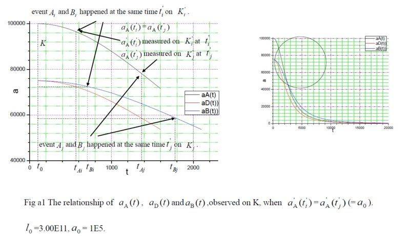

Each spaceship has its own original time τ.
For spaceship A at its every original time, such at time τi, there exists an inertial reference frame Ki spaceship A and spaceship B is rest in Ki. When the original time of spaceship A is τi , corresponding time in Ki is ti.
For spaceship A at time τj, there exists an inertial reference frame Kj spaceship A and spaceship B is rest in K. When the original time of spaceship A isτj , corresponding time in Kj is tj.
Measured in Ki at time ti and measured in Kj at time tj, the acceleration of spaceship A is a constant.
The distance of spaceship A and spaceship B is l0 measured in Kj at time tj.
Thank for stevendaryl.
  • Graph of a against t with curves aA(t), aD(t) and aB(t) on axes running to 100000 and 20000, with arrows marking events Ai, Bi, Aj and Bj and labels Ki and Kj. Inset plot of the same curves labelled aA(t), aD(t), aB(t). Caption: Fig a1, l0 = 3.00E11, a0 = 1E5.

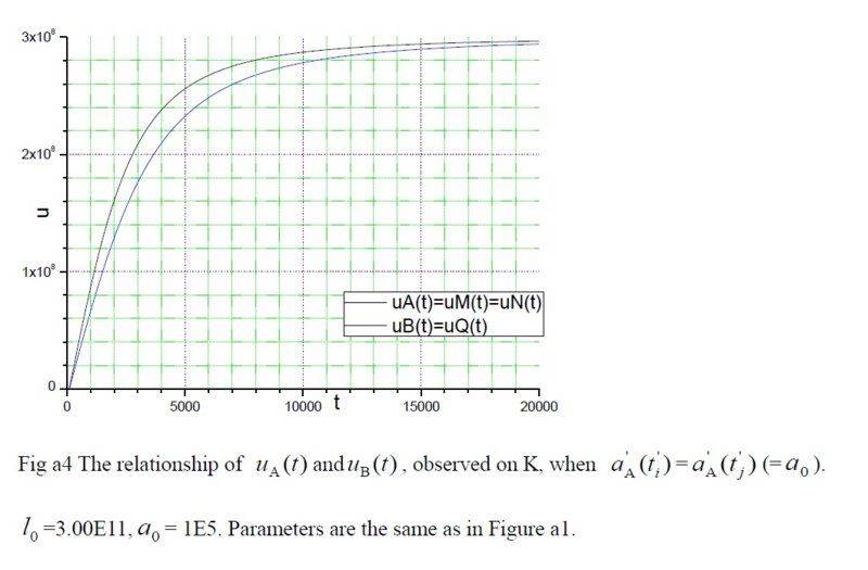

  • Line graph of u against t from 0 to 20000, with two curves rising and levelling off near 3x10^8: uA(t)=uM(t)=uN(t) rises faster and uB(t)=uQ(t) rises more slowly.

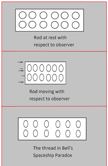

Then I don't understand how an object can get shorter.
Three stacked panels of a diagram: a rod of twelve circles in two rows at rest with respect to observer, the same rod with its circles squeezed closer and arrows pointing left when moving, and the thread in Bell's spaceship paradox showing the rod's circles spaced narrower.
David Lewis said:
Then I don't understand how an object can get shorter. View attachment 243696
If molecules had a shape, they'd get shorter. In the world of quantum mechanics, though, it's not clear if molecules actually have shapes or not, at least not to me. I would say that molecules have wavefunctions which occupy a non-physical "configuration space", with 3 dimensions for every particle in the molecule (presumably these particles are atoms, but you could break the atoms down into more particles). That's not really a "shape" as far as I am concerned.
Most treatments of introductory QM treat single particle systems, where the wavfunction does occupy normal space. It's when one considers multi-particle systems that one gets into the issue of the wavefunctions not occupying physical space.
But it's much simpler to keep the arcane aspects of QM out of the discussion, which is what the original point was.
Because that's how the geometry of spacetime works. The SR treatment of the Bell spaceship paradox does not make any hypothesis about the internal structure of the object. It just explores the consequences of the stated conditions, given the geometry of Minkowski spacetime. This geometry puts constraints on any model of an object's internal structure; but it doesn't tell you anything specific about that internal structure.
As far as an "object" describable by classical physics is concerned, Lorentz showed in the 1890s (IIRC) that any object made of electric charges bound together by electromagnetic fields would exhibit length contraction in a frame in which it was moving.
The string in Bell's scenario doesn't get shorter, so the contracted binding EM fields have to span the same distances. Hence the tension. To avoid the complications of QM don't go down to the atomic level, but instead consider the contracting links of a chain that is forced to keep a constant length.
