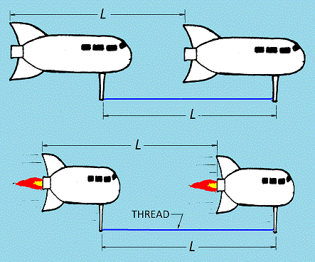

While the picture shows the rocket engines being located in the back, the thought experiment question makes no such designation. Considering this is a thought experiment, shouldn't we consider an engine that applies the thrust uniformly across the entire ship??
Also, is it from the perspective from the initial state that the distance between the ships is constant? Wouldn't this mean that from the perspective from someone on one of the ships, the distance between the ships is increasing? A stationary observer would see the spaceships being length contracted and the space between the ships being length contracted as well in order for the people in the ships to see no difference. Isn't this paradox just an impossibility?
Yes. More precisely, the distance between the ships is constant as seen in the inertial frame in which both ships are initially at rest (before they turn their engines on).
Yes. Have you read the FAQ entry I linked to earlier in this thread? It discusses this.
Yes.
No.
The people on the ships do see a difference; they see the distance between the ships increasing. See above.
No. You apparently have not read the FAQ or any of a number of articles on the paradox, all of which discuss and resolve the issues you raise.
