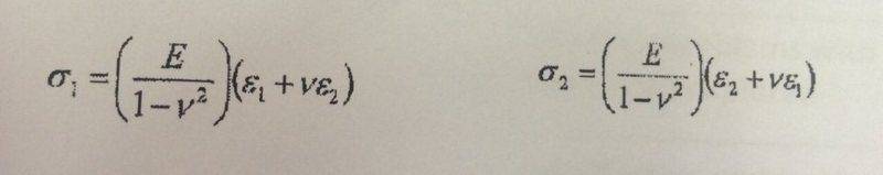

StevenBennett

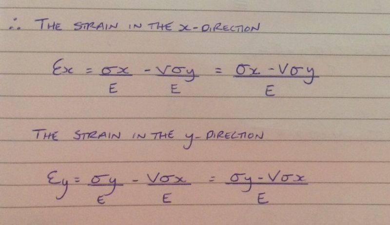

I need some help converting and rearranging the first formula to get the next formulas? As I need this for further reference, for a future assignment!
Not homework!

You have two linear algebraic equations in two unknowns, correct?

Yes that it correct, I just cannot figure out how to reach the equations in image 2
Please show us your algebra.
