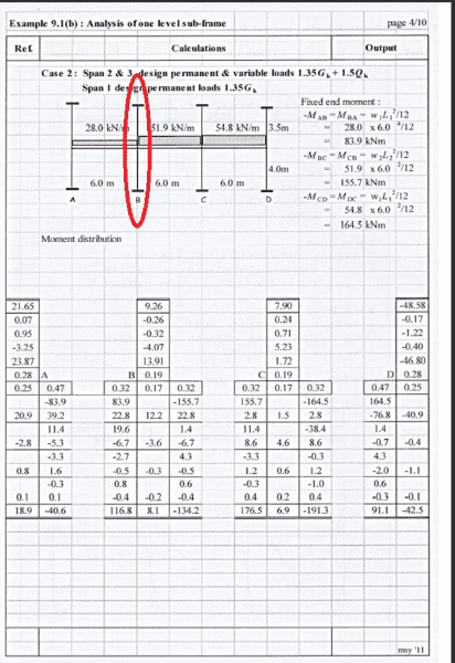

How to obtain the axial force from beam transfer to column ? Say that I'm going to design the column at B . how to obtain the axial load ?

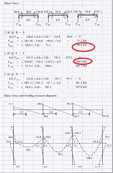

I think it should be 96.6+148.6=245.2 ? I have read another source , it's stated that the axial load is (28.0x6/2)+ (51.9x6/2) = 239.7 ...Which is correct ?
I think 96.6+148.6=245.2 is correct , because we already have the shear force directly from the SFD from the beam , so , we can directly transfer the load from it to the column ...
Please correct me if i am wrong .

  • Moment distribution table from a structural analysis worksheet, Example 9.1(b), page 4/10, Case 2 with span loads 1.35Gk + 1.5Qk, showing fixed end moments and distribution values for the frame, with the column at B highlighted by a red oval.
  • Worked shear force calculations for a continuous beam with spans of 6.0 m, plus shear force and bending moment diagrams below; end shears 71.2, 96.6, 148.6, 162.7, 147.8 kN marked in red.
You are not wrong, but neither is the other answer. This is a statically indeterminate beam , so you need to resort to an approach like virtual work or moment distribution in order to solve it for the exact solution. However, it is customary for engineers to approximate thecolumn loads by assuming that each column supports one half of the uniform loadingto the left of it and one half to the right of it, which gives a pretty good approximation. It saves a lot of time and avoids the tedious and time consuming exact analysis, and avoids modeling into a computer software program, both of which could lead to errors. Extra time is money lost. And don't forget the safety factor makes the approximation difference insignificant.
