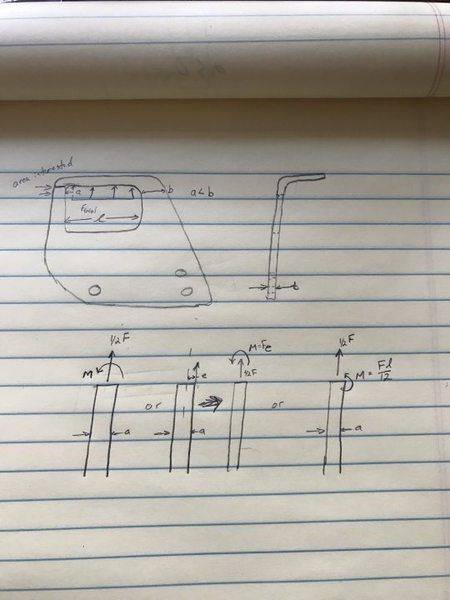

I have designed a bracket and am interested in stress at a certain point. I have figured out the load needed to support. The area of interest carries an eccentric load so bending moment and axial load need to be figured out. Not sure which FBD is correct to use.
See picture
  • Hand-drawn sketches on lined paper of a bent bracket: a plate with holes and an arrow-labelled load, a side view of its bend, and three free-body diagrams of a thin section showing an upward force F/2, a moment M, and an offset distance e.
Sketch the bracket more clearly and in 3D so that we can understand the problem better .

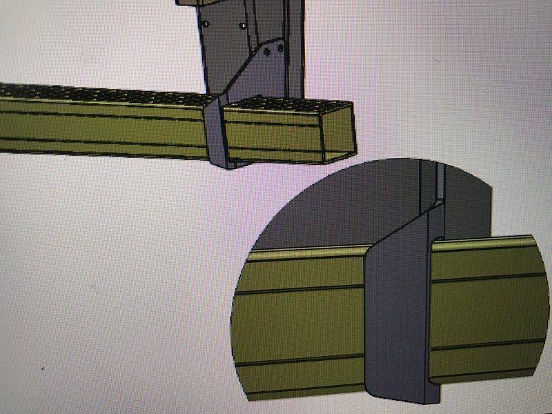

This shows how it straps the tube. The tube is what gets hit.
  • CAD render of a steel bracket with a gusset plate joining a square tube, shown beside a larger rounded olive-coloured tube section clamped by a grey plate.

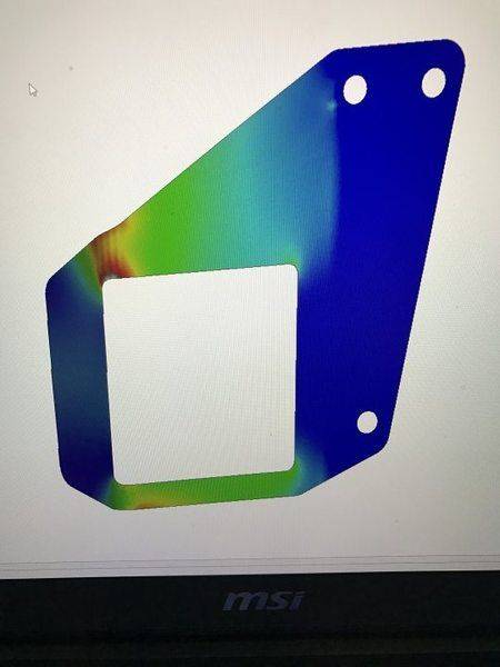

Ran an FEA for fun.
  • Finite element stress plot of a flat bracket with a large square cutout, four holes near the corners, and a colour scale from blue (low) through green to red (high), with the highest stress concentrated at the upper-left and lower-left corners of the cutout.
