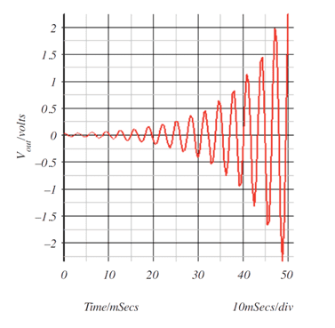

When testing the circuit of FIGURE 1 (a) it was found that the output shown in FIGURE 1 (b) was obtained when the input was connected to ground.
explain why this was so and attempt an estimate of the capacitance values of C.
estimating the waveform as 7ms the formula f = 1/T was used to get the frequency of 142.857Hz
assuming C1 = C2 and R1 = R2
the formula f = 1/2πCR was used, rearranged into C= 1/2πfR to give capacitance as 111uF.
any help is much appreciated in giving me any advice as to whather this is correct.
I don't see T = 7 ms
I count about 10 peaks in the last 30 ms , or about 3&a bit cycles between 20 and 30 ms.
I see no R!, R2, C1, C2
The two R values are given and the two capacitors are marked the same, C , so no assumptions needed.
Ok formula, but I don't get 111 uF, with either your frequency or mine.
The shown circit is a so called "WIEN bridge oscillator".
And oscillator has no signal input at all - hence, it is quite logical that the 3.9k resistor must be connected to ground.

Do you not think the question wanted an explanation of the WBO?
I thought they did not sayWBO so that the reader would tackle it as a simple op-amp circuit with a Wien Bridge feedback circuit, explain the effect and magnitude of the WB fb, the choice of resistors for the negative fb and the significance for the form of the graph.
I expect you are supposed to recognise it as a Wien Bridge circuit, else some of us would struggle to calculate the properties of the +ve fb cct from scratch.
And just out of interest, would the circuit not oscillate if the input were at some other potential? (such as +1.5 V or - 0.7 V, not +13.8V etc.)

In the problem formulation I did not read the term "oscillator". So I was not sure if the questioner did know that the circuit will produce self-contained oscillations.
More than that, from the first sentence I`ve got he impression that he was surprised to observe any output without an input signal.
That was he background of my answer.
It was not my intention to explain the oscillator principle - including loop gain, oscillation condition, start conditions, amplitude control ...
PS: Why didn`t YOU try an "explanation of the WBO"?

When I first saw it, I thought that it was an unstable amplifier. The output shows it bursting into oscillation (as one I might build possibly would!).
