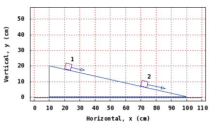

In summary, a cube with a mass of 0.425 kg is pushed down an incline of 12.5* and its speed is measured at two positions, with V1 = 0.913 m/s and V2 = 1.171 m/s. The goal is to calculate the coefficient of kinetic friction (μk) and the travel time of the cube from position 1 to position 2. Attempt 1 resulted in incorrect values for both μk and the travel time. The solution involves calculating the acceleration down the incline and using kinematic equations to determine μk.

A cube of mass M=0.425 kg is placed on an incline of 12.5* and given a push. It slides down, and its speed down the incline is measured at two positions, [1] and [2] on the diagram below, with V1 = 0.913 m/s and V2 = 1.171 m/s. Note that the incline passes through at least two grid intersections and that one cube corner is at x grid lines. (See attachment.)
A. Calculate μk, the coefficient of kinetic friction for the block on the incline.
B. Calculate the travel time of the cube from position 1 to position 2.

What is the problem? Just calculate the acceleration down the incline with a supposed coefficient of friction. Then use kinematic eqns. to make out the coefficient.
