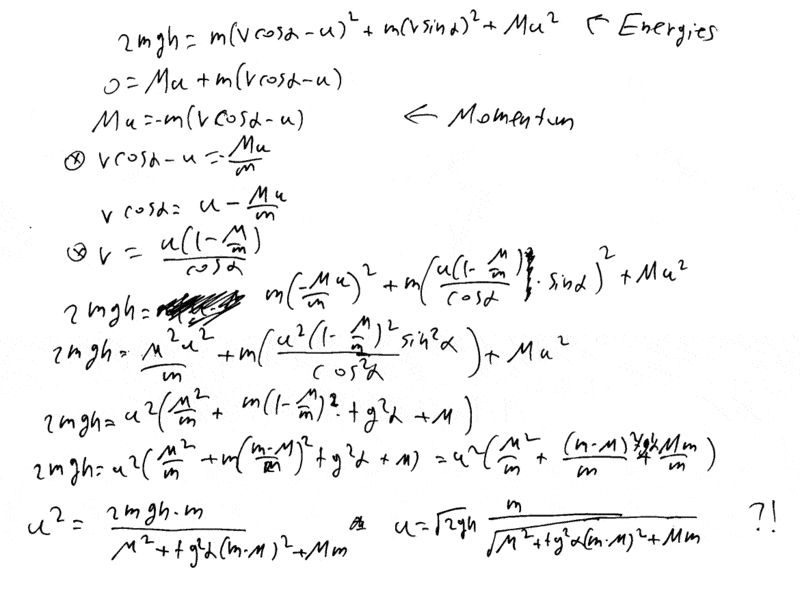

So here is yet another attempt.
I'm out of ideas.
Where did I go wrong?
I haven't had a chance to look at your attempt in detail (I will a bit later), but at first glance:
(1) Your energy equation is OK.
(2) Correct your momentum equation: The velocity of the wedge is -u (u is positive).
It works. You should correct your momentum equation as Doc Al has suggested. From the momentum equation you should get
[tex]v cos\alpha = \frac{M+m}{m}u[/tex]
In order not to confuse your u with the book's u, let
[tex]\frac{M+m}{m} = \frac{1}{\beta}[/tex] so that
[tex]v cos\alpha = \frac{u}{\beta}[/tex]
Put that in your energy equation and it should come out.
Ok, I got it. Thanks!
