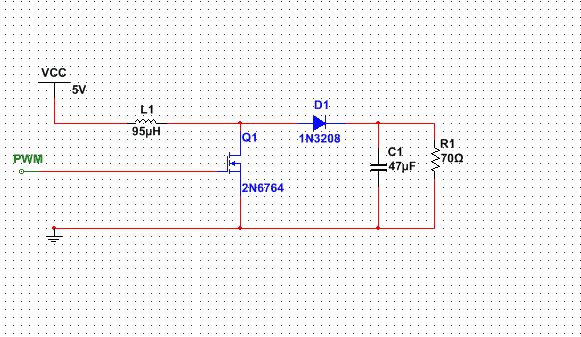

I have recently learned about the boost SMPS and and have built a circuit to investigate the waveforms and levels for Vout, [L] and [C] for different mark space ratios.
the circuit consists of a 95uH inducotr, diode, 47uF cap, 70 Ohm load, a FET who's gate is controlled by a PWM and a 5V input

It would be helpful if you could attach a schematic diagram of your circuit. Also, a sketch or photo of the current waveforms.

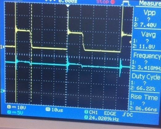

Photo 3 trace 1 is the waveform at the node of the inductor, diode and the FETS drain, trace 2 is the output voltage

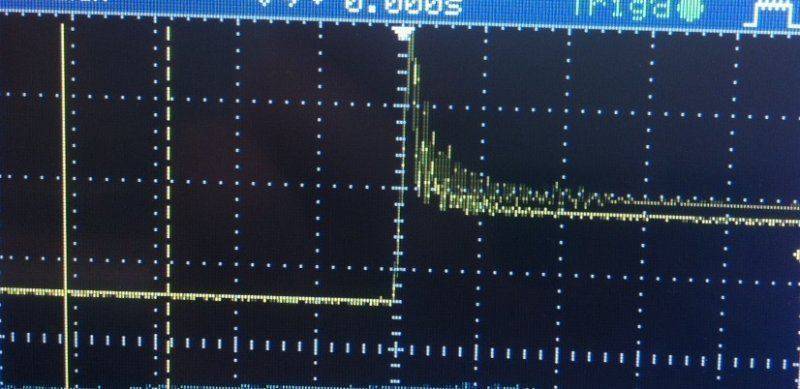

Photo 2 is the rining on the rising edge of the pwm
Those all look as expected. It's often debatable whether ringing that's visible is actually there when you don't have the CRO leads attached, or whether this is introduced by the leads themselves introducing L and C on an aerial. For example, you could try a 220k resistor from gate to ground, this will probably clean up the appearance of the PWM waveform; capacitance from drain to gate or wiring capacitance may be feeding this back from the drain. You could try a 0.01uF in parallel with the electrolytic.
As a test, just resting your finger on some of these points may clean up the waveform, where the ringing is coming from a high impedance.
Energy in an inductor is ½LI² and this gets dumped into the reservoir capacitor when the FET turns off.
What is ߡV between the two DC levels in the yellow waveform? Is that big spike higher every second cycle?
You can see the inductor current is characterised by two linear regions. If you measure those slopes you should be able to compare them with what they should theoretically be. Remember, for an inductor v=L.di/dt

The theory states Vout = (T/Toff).VS for the results in the table/ the pictures i get Vout = 40us/ 27.2us *5 = 7.35V . Which is not correct as the output can be seen to be roughly 14V in the third picture.
The spikes occur every cycle and are roughly the same hight give or take quarter of a division. it was hard to adjust the trigger to keep the trace still so the pictures were taken with the display stoped.

You're confusing Ton and Toff.
In your setup, Ton = 27.2 us. Look at photo 3 trace 1. The low part is for Ton.
So you should get Vout = 5V(40us)/13us = 15.4V. The diode drop accounts for most of the error.
