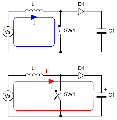

hi baluncore, this is my circuit...
Inductive kickback is usually restricted to the destructive voltage spike that occurs when turning off an inductive load.
The circuit has two states, decided by the position of SW1.
While SW1 conducts, voltage across L1 is positive, so current flow in L1 rises. Vs = L * di / dt
While D1 conducts, voltage across L1 is negative so current flow in L1 falls. (Vs – Vc1) = L * di / dt
The current always flows the same direction through L1 but the polarity of L1 voltage reverses.
When current flows uphill through L1 into C1, I believe you are calling that inductive kickback.
There is a voltage step from ground to Vc1 when SW1 turns off.
There is no high voltage spike because it is clamped by D1 into C1.
D1 is an automatic switch that blocks current flow from C1 through SW1 to ground.
D1 automatically conducts when SW1 does not. It allows L1 current to charge C1.

hmm...understood a bit...but still have doubt...say switch SW1 is closed, at that time inductor gets charged, but why not diode can conduct at that time?...please clarify me...
The diode can only conduct current in one direction. It is a one way valve.
While SW1 conducts the diode has reversed voltage so it does not conduct.

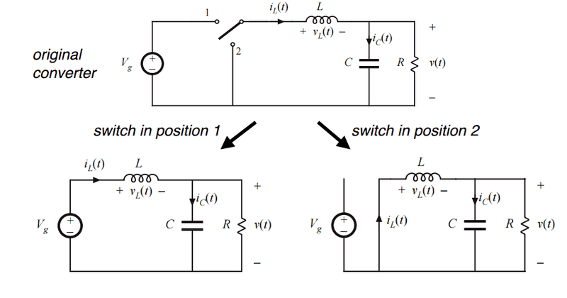

thanks...baluncore...why is that during analysis the polarity of inductor is kept same, I mean when SW1 is closed inductor has + - polarity but when SW1 is opened, inductor has -+ polarity (thats y diode comes into picture)...but during both switching modes inductor polarity is kelp +- in many books...can you please clarify this also..thanks
They might be more common buck converters that reduce the voltage. Post an example and I might be able to comment.

Do you mean something like this ?
http://ecee.colorado.edu/copec/book/slides/Ch2slides.pdf
The author did a good job in confusing the beginners.This is a very bad habit to show "pre-analysis polarities". The polarity of inductor voltage is what he (the author) decide to choose before solving the circuit. So this diagram did not show "actual polarities".

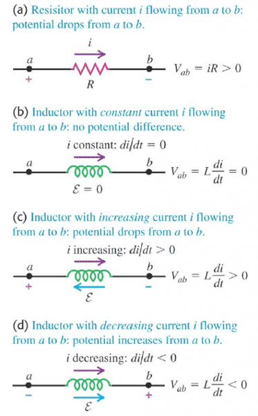

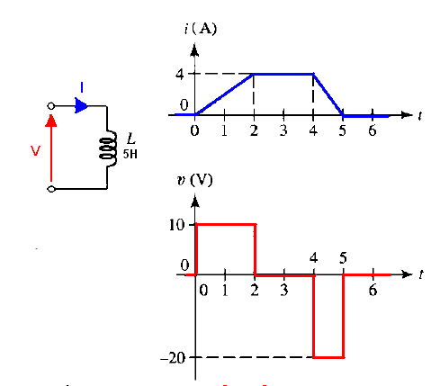

And remember one thing:
The voltage across an ideal inductor is VL = L* ΔI/Δt
This equation indicates that inductance voltage depends not on current which actually flows through the inductance, but on its rate of change. This means that to produce the voltage across an inductance, the applied current must change. If the current is kept constant, no voltage will be induced, no matter how large the current. Conversely, if it is found that the voltage across an inductance is zero this means that the current must be constant but not necessary zero.
In summary:
When the current is increasing di/dt > 0, so V must be positive because L times a positive number yields a positive voltage.
When the current is decreasing di/dt < 0, so V must be negative because L times a negative number yields a negative voltage.
When we have no change in current over time then we can't have any voltage V = L*di/dt = L * 0 = 0.

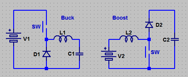

On of the best resources is the TI PS Topologies Poster
Here you see the waveform for the various elements -
I also like to point out that inductor is essentially the opposite of a Cap. Vind = L dI/dT vs Icap = C dV/dT. When you charge a cap current flows "in" one direction and then with the same polarity of voltage the current can reverse and flow out. The inductor - the current can be the same polarity but the voltage changes polarity,
Next -- what is happening?, we are storing energy(power input) in the inductor while the switch is closed, and the inductor is supplying energy (power output) when it is open, To change the Direction of power flow ether voltage or current must change polarity. In a Cap the current changes - in an Inductor it is the Voltage.
It is easy to get in the habit of drawing ladder diagrams for analysis of circuits. But ladders are view best suited to a mathematical analysis. The TI poster referenced above in post #10 uses ladder diagrams.
When trying to show or understand quickly how a circuit works, I prefer to keep high voltages at the top of the diagram with low at the bottom. The source or input is on the left with the load or output on the right. Attached is a diagram showing buck and boost converters as an example.
Notice that the two alternate switch paths are placed parallel in line. The “inherent” switch diodes are shown with an orientation as reverse biassed to make their use clear. You will also better notice the mirror symmetry of topology in the step down and step up circuits.
yes jony130...i was mentioning this one...why is that the author hasnt changed the polarity for inductor?? i mean for circuit analysis..?! is there anything wrong if change the polarity and solve the circuit??
