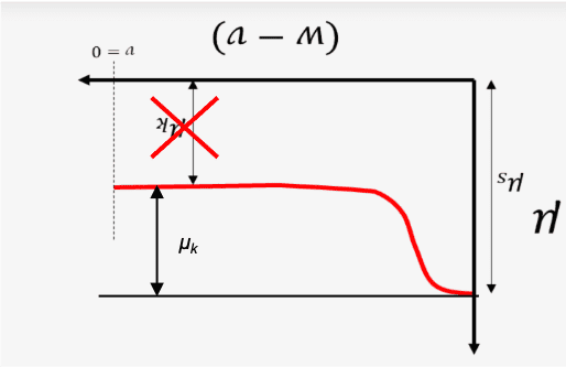

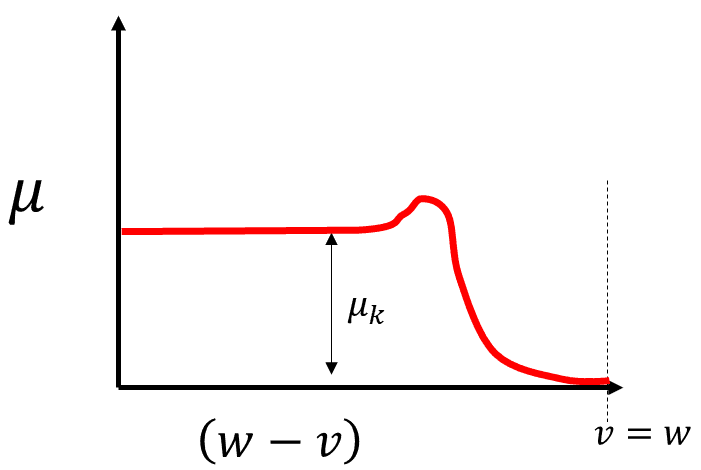

Let say a package is entering a conveyor belt (velocity ##w##) at zero initial velocity ##v## in the direction of the conveyor.
Initially the package slips as its being accelerated (from rest) to conveyor belt speed. A linear drag force seems reasonable to me for a model:
$$ \beta( \mu, N ) ( w - v ) = m \frac{dv}{dt} $$
##\beta## has dependency on ##\mu## (which has dependency on the relative velocity), and the normal force ##N##, such that ##\beta## is dimensionally consistent. However, if we ignore that for a moment( assuming ##\beta## is a constant) you get the following solution for ##v(t)##:
$$ v(t) = w \left( 1 - e^{-\frac{\beta}{m} t } \right)$$
The problem, with ##\beta## as some constant (if its a problem?) is in this simplification, the package never quite reaches belt speed... it just becomes arbitrarily close to ##w## as ##t \to \infty##:
If we address the fact that ## \beta## is not constant by examining a plot of ##\mu## vs ## (w-v)##: it should look something like this:
The question I have is if you were to formulate that function for ##\beta## using the characteristics of ##\mu## above would it fix the issue of the package reaching belt speed in finite time, because it at least seems to do so in reality?

You could have an increasing ##\beta##, but that does not seem physical. I also do not like the high speed limit (##\infty##). In my experience, friction decreases with velocity. Given that both limits are questionable, I would avoid the functional form. My first attempt would be a constant frictional force, ##\mu mg##.
Suppose you are an observer sitting on a box that is already at rest relative to the conveyor's inertial frame. You see a box coming down with zero horizontal velocity. As soon as it touches the belt, it receives an impulse that gets it sliding away from you until it stops. The modeling is the same as that of a block on a horizontal surface being given initial velocity ##v_0## and moving across until it stops. In that case we teach that the force is constant until the very end when it becomes velocity-dependent and drops sharply.
I agree that assuming a constant force of kinetic friction is only an approximation, but you don't need the conveyor belt to devise a more realistic model. Just model kinetic friction differently. I think what you want is the red line below. The vertical axis is frictional force divided by ##mg##. Please excuse the sloppy plot.

Yeah, I guess any dynamics that are going to happen with ##\mu## are going to happen very near ##v = w## regardless.
It is not clear to me whether ##\mu## increases or decreases at small velocity differences. I would argue that at some point it begins to increase to static friction values. I do not know if there is a region before that where it decreases.
Yeah, it seems to do some funny things.
if the belt is moving at constant velocity, then as ##v \to w ## the net force acting on the box has to go to zero. However, if the belt was accelerating at ##a## the then net force acting on the box as ##v \to w## has go to ##ma##, indicating ##\mu## climbs to ##\mu_s##...
I guess there is a likelihood that if the belt were accelerating "it never catches up" to consider.

It is more than a changing ##\mu##, it is changing friction mechanisms. Also, as you point out, slip can occur.

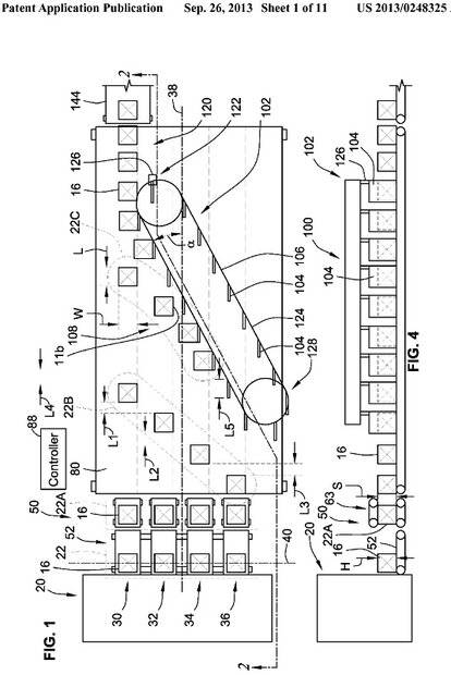

I have considerable real world experience with exactly this problem. Stacks of napkins and sheets of corrugated instead of boxes, but the analysis is identical. The analysis is as follows:
1) Assume/determine initial velocities and dynamic friction coefficient.
2) Calculate time and sliding distance to accelerate to the speed of the belt or skid to a stop.
3) Then it moves with the belt or stays stopped.
Assuming constant dynamic coefficient of friction makes the calculation easy, and the results agree very well with observations. These calculations are done by hand because they are so simple. Real world calculations of this type are done using the simplest method that gets the job done because the engineer has two goals:
1) Solve the problem.
and
2) Effectively communicate the results to other engineers and to management, so we do not mention differential equations.
This figure from a patent application, is a direct copy of the figure produced by the engineer of a complex version of the problem in the OP. The complexity is only from the challenges involved in keeping track of numerous single box problems, or single napkin stacks in this case.

This model is a fairly easy one to validate. All you need is a long flat tiltable surface and a box. Tilt the surface until you get your ##\mu_k##, start the box sliding, then check its speed as it slides down. If the model was perfect, the speed would be constant. Or if the tilt was inexact, the acceleration would be constant.
So using this for the OP problem, the package will accelerate linearly at ##g\mu_k## until ##v_b## reaches zero.
The force does not drop as the relative velocity (##v_b##) drops. In fact, if we allowed the effects of static friction to come into play before ##v_b## reached zero, the acceleration would momentarily increase.

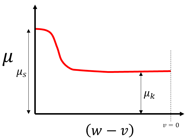

Thats wouldn't seem to be able to verify the points of interest though ##v \to w## . I was trying to think about what happens in the transition for the box velocity ##v## to a constant conveyor belt velocity ##w## as slipping ceases?

If the effects of static friction extend beyond v=0 as the charts in this thread depict, then yes.
