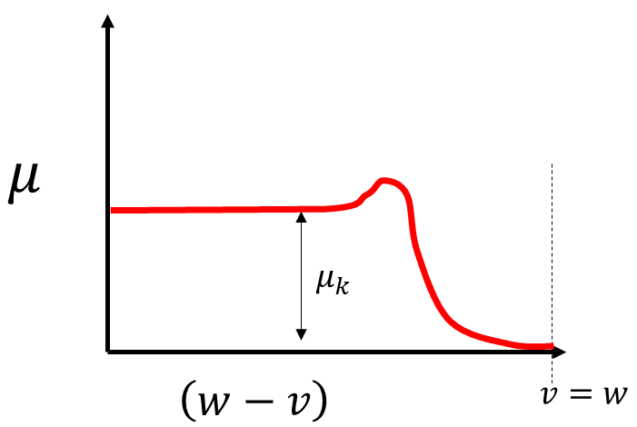

  • #32
.Scott said:
If the effects of static friction extend beyond v=0 as the charts in this thread depict, then yes.
Something to the effect of the following?

  • #34
No. In the "Freshman" model, the coefficient never drops below ##\mu_k##.
In the modified model, where we speculate a transition to ##\mu_s##, the red line would end by rising to ##\mu_s## as it reached ##v=w##.
In the unmodified "Freshman" model, there is no transition - just an abrupt jump from ##\mu_k## to ##\mu_s##.
  • #35

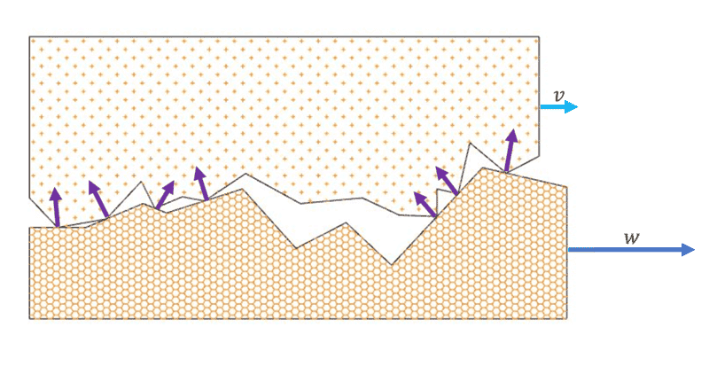

After @Frabjous mentioned about the microscopic scale, I was thinking that the rough belt ( a jagged surface) is applying little impulses to the rough box (another jagged surface) as is slide past it. At some speed these impulses are plenty enough to just imperceptibly raise the COM of the package as the interlocking surfaces slide over(under) each other. However, at some point ##v## close to ##w## these impulses can't supply that vertical force ( acting through the "micro normals"), so the surfaces just stay locked relative to each other.
Something like this picture. The impulse delivered to the upper block from lower section of belt would have to be such that the box slides over the microscopic hills and valleys of the belt. Once it fails to deliver sufficient impulse as ##v \to w## they stay locked relative to each other. Basically, the box c.o.m. is oscillating vertically on a microscopic scale as the belt slides underneath it.
