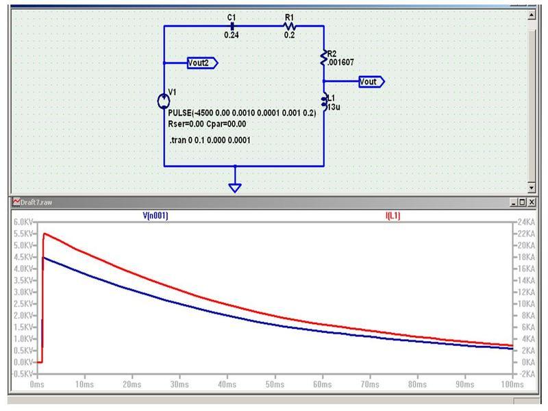

Here is a Spice analysis of your circuit. See thumbnail. The values I have used are:
V capacitor 4500 volts
C capacitor 0.24 Farads
R capacitor 0.2 ohms
L inductance 13 uH
R inductance 0.001607 ohms
Please check these values. The capacitor internal resistance is very important.
Red curve current in inductance - right scale
Blue curve capacitor voltage - left scale
The pulsed current goes over 21,000 amps.

does that graph account for the effects of self induction? from what i can tell, the time taken for the current to grow to a maximum should be 5 * L/R =0.041 seconds, in other words, wouldn't my pulse need to last at least that long before the current in the coil were, in your case, 21000A?
The only inductance not accounted for is the self inductance of how your overall circuit is laid out. If for example, you laid out your circuit as a 0.5 meter radius b= 0.5 meters circle using a conductor radius a = 0.005 meters, and all the currents flowed on the surface of the conductor, the self inductance would be (See Smythe Static and Dynamic Electricity 3rd Edition page 340)
L = u0b [Ln(8b/a) - 2] = 2.9 microhenrys
which is small compared to the 13 microhenrys of your coil.
By the way, the L/R time constant is 13E-6 henrys/0.2 ohms = 65 microseconds, unless I am missing something. Are you sure the inductance of your coil is 13 microhenrys?
oh is that how it works? i calculated my time constant using the resistance of my coil only(approx 1.7 mOhm), do i have to calculate it using the total circuit resistance(approx 0.2 ohm)? More specifically, and just to be clear, would the current pass through my coil in 5 * 65 us (for total resistance), or 5 * 7 ms (using coil resistance only)
Your system time constant is determined by capacitance and resistance:
RC = 0.2 ohms x 0.24 Farads = 0.048 seconds. Are the R and C input values correct?

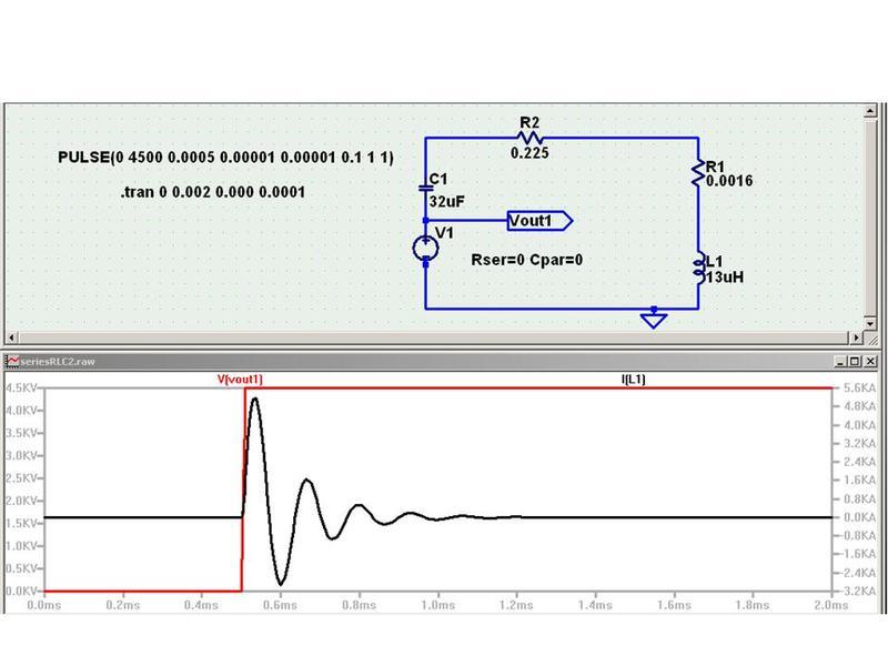

Also Bob, could you please show me the output of 4 of these capacitors through my coil:
C = 32 microfarad
R = 0.225 ohm
V = 4500 V
Hi trini-
Here is a run with your new values. Voltage is plotted in red, and use the left scale. Coil current is plotted in black, and use the right scale. The capacitor is certainly resonating with the coil, even with the series resistance of 0.225 ohms. The first half cycle is about 100 microseconds wide, and goes up to about 4,800 amps (peak). There is a significant undershoot, which may damage your capacitor if it is unipolar.
Bob S

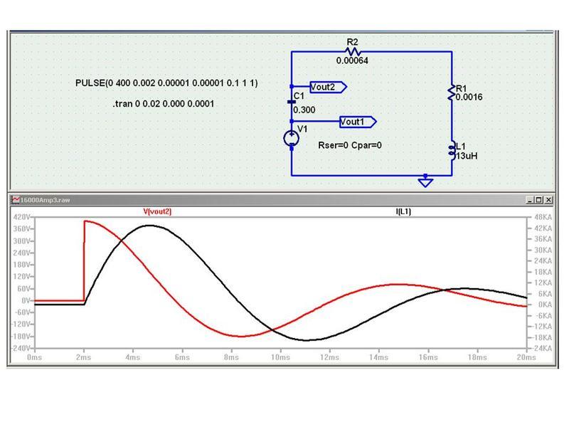

i'm still looking around for the most economical solutions to this bank, and have sourced some nicely priced high capacitance capacitors. could you show me the output of 25 of these capacitors in parallel:
12000 microfarad
400 V
0.016 ohm
thanks for all your help so far bob, you're really giving me motivation to see this through!
trini
OK. 25 x 12,000 uF = 0.3 Farads, 0.016 ohms/25 = 0.00064 ohms, 400 volts.
See thumbnail. Black curve is coil current, see scale on right. about 42,000 amps max. Red curve is capacitor voltage, see scale on left, 400 volts max.
Bob S

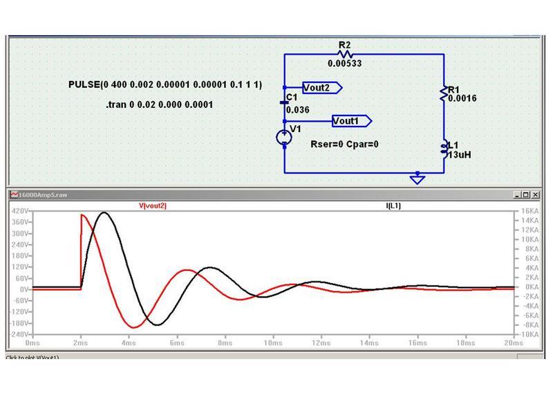

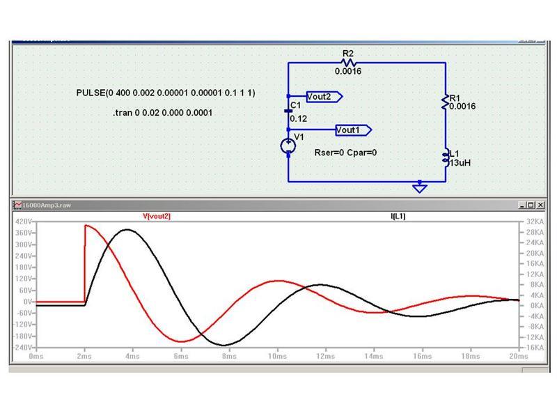

wow that's fantastic! I only need 20000 though, could i get a readout of 10 in parallel?
so total:
C = 0.12 F
R = 0.0016 Ohm
v = 400 V
Trini-
See plot of your new circuit with 10 caps in parallel. Peak current now about 29,000 amps.
Bob S
