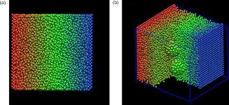

At time zero, you place a hot conductive semi-infinite solid slab in contact with an identical cold conductive semi-infinite solid slab, and let nature take its course. What do the temperature profiles look like within the two solids at times t > 0? Is the temperature a continuous function of spatial position, including at the boundary? Is the temperature gradient continuous at the boundary? Is the heat flux continuous at the boundary? What are the temperatures in the slabs far from the boundary? What are the the temperatures at the boundary?
Chet
Chet
The profile looks like this at the boundaries or the interface of two conducting surfaces. I'm actually lost by the term "continuous", my apology "english" is not my native tounge.
Yes. This is more like it. I just wanted to clarify what you were saying. By continuous, what I mean is that the temperature does not change by a finite amount when one crosses the boundary between the two materials.
