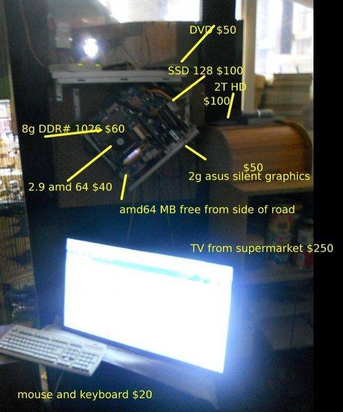

Here's my own PC. "Outside the box, or: no box".
When I hang it on the wall like this it's easy to plug in and remove things.
With the screen it comes to about 700.
Long term operation like that is not exactly the best idea. Cooling is compromised. There is a concern with EMI both in and out of the system. Noise will be a bit higher too but that can be mitigated with proper component selection.
Dust ingress is a mixed bag. You get more dust collection but you can better see when the cooling devices need cleaning or replacing.
BoB
The point about dust is very good. One reason I like this setup.
Cooling works fine. I tilted it so that no heat from components rise on to any others. It survives the Australian summer with no airconditioning. Often in the mid 30's. A must to keep the dust to a minimum. A blow with pressurised air a few times a year.
Noise is no problem at all. A quiet power supply behind, an ssd, and no fan on the video card. It's quieter than my last setup which was in a box with cooling fans. Plus I can easily see, smell and feel all components.
The only thing is I'd never have kids or clumsy people around it.
