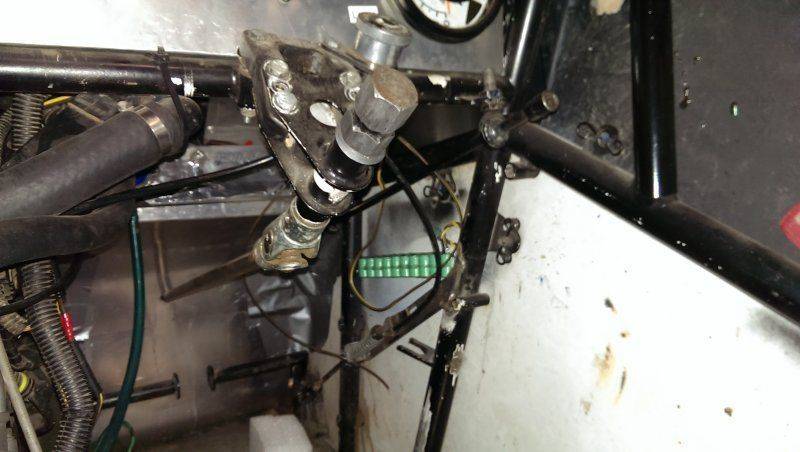

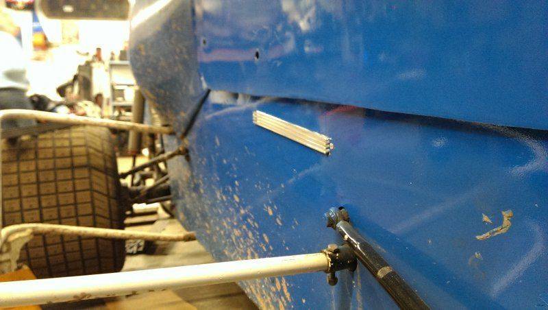

the install of the capacitors is done and there is no heat at idle. I retested the DC voltage and have blown another voltage regulator.
what is my next step to replacing the current type of regulator with one that will work?
i would like an off the shelf part if possible.
Please help if you can.
Known information:
-- stator output 10V AC through 45V AC
-- stator output of 150Hz at idle and 850 at top rpm
-- DC converted by a Bridge rectifier and has 10 - 4700uF capacitors in parallel.
-- current regulator is a "shunt" type wired in parallel
-- Load is 12V DC, 80 watt brush fan motor and a couple of 7 watt light bulbs continuous and very intermittent use of a 18V DC Craftsman drill motor (used to move a wing front to back on a sprint car).
