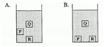

There is three things P, Q, R. The density of P is 2000 kg/m3, Q is 1000 kg/m3, R is 2500 kg/m3. If all of them are put into the water having density 1000 kg/m3, the correct position of the things are shown by following picture ...

There are three things P, Q, R. The density of P is 2000 kg/m3, Q is 1000 kg/m3, R is 2500 kg/m3. If all of them are put into the water having density 1000 kg/m3, which one is the correct position of the things? Picture A or Picture B (see attachment)?
What is your choice? Can you apply your relevant equations to definitely rule out one of the choices?

Look at image A:
Check each of the objects P, Q, R against your relevant equation criteria. What do you find?
Sorry this is my attempt at a solution :
At first I chose picture B because things P and R are solid, so they will go to the bottom of the container. Whereas, my teacher choose picture A.
You mean that P and R are both more dense than the fluid, so they should both sink to the bottom. That is true, and I agree with your choice of B as being correct.

I think P position is impossible, it must be in the float halfway or sink. On the other hand, my teacher say that the correct answer is A. It's to make sure that the density of R is greater than P so that R position is lower than P position. According to you, does my teacher's reason make sense?
No. If an object's density is greater than that of the fluid it will sink to the bottom. Both P and R have densities that are greater than that of the fluid, so they must sink to the bottom.
The only time an object can "hover" in the fluid without moving up or down is when it has neutral buoyancy. That means its density is equal to that of the fluid. That only holds for one of the objects.

Okay thanks gneill, now I confident with my answer and learn more from you.
