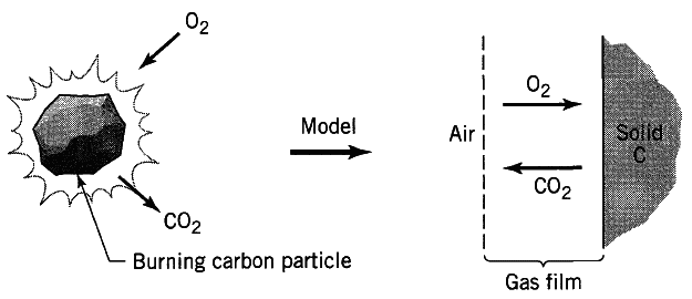

I want to model the diffusion-controlled combustion of a small carbon particle. The system I want to model is similar to this one
Diagram of a burning carbon particle with O2 arrows pointing in and CO2 arrow pointing out, next to a model showing air, a dashed gas film boundary, and solid C with O2 and CO2 arrows.
However, I'm not going to use the stagnant gas film model as shown in the figure, since I lack data for the film thickness, and I want to evaluate the problem numerically. Instead, I'm going to use spherical coordinates with boundaries r = R, the radius of the carbon particle, and r = ∞. I'm going to assign A to O2 and B to CO2 for the mathematical models. I will be using molar fractions because the global molar density of the system can be considered to be constant. The diffusion equation, concentration profile and molar flux in terms of A are given by
[tex]\frac{d}{dr} \left( r^2 \frac{dx_A}{dr} \right) = 0[/tex]
[tex]x_A = x_{A \infty} \left( 1 - \frac{R}{r} \right)[/tex]
[tex]N_{Ar} = - \frac{c \ D_{AB} \ x_{A \infty} R}{r^2}[/tex]
Where xA∞ is the molar fraction of oxygen at r = ∞. The negative sign in the molar flux expression is there because oxygen is diffusing towards the carbon particle. My problem lies within giving a numerical value to xA∞. The statement says the particle burns in presence of air, so first I let xA∞ = 0.21, but that creates a problem. For this scenario, [itex]N_{Ar} = - N_{Br}[/itex], and if I make the analysis in terms of B, I obtain the following expressions
[tex]x_B = x_{BR} \frac{R}{r}[/tex]
[tex]N_{Br} = \frac{c \ D_{AB} \ x_{BR} R}{r^2}[/tex]
The problem is that xBR, the molar fraction of CO2 in the surface of the carbon particle, is always 1. Then I'm forced to assign xA∞ = 1, in order for [itex]N_{Ar} = - N_{Br}[/itex] to be satisfied. The problem is that the particle is burning in air, not oxygen, so what about the presence of nitrogen? Do we just consider species A and B and neglect any other species present in the system? Do we ignore nitrogen because it is not participating in the mass transfer process? The process is diffusion-controlled, so I ignored the kinetics of the combustion and setted [itex]x_A |_{r=R} = 0[/itex] and [itex]x_{BR} = x_B |_{r=R} = 1[/itex].
My ultimate goal is to calculate the time it takes for the carbon particle to consume completely, using a quasi-steady state analysis. I have enough data to calculate this, but I want to sort this boundary condition issue out first.

I don't see why you are saying that the mole fraction of B at the particle has to be 1. What about the nitrogen in the air at the interface? Where is the diffusion coefficient in your radial diffusion equation? The boundary condition at the particle should be that the flux of B is minus the flux of A. And B has a different diffusion coefficient than A.

Well, it hadn't occurred to me to consider the nitrogen presence in the boundary at the particle. If I take into account the nitrogen in the whole system I guess I could say xBR = xA∞ = 0.21.

Both A and B are diffusing through nitrogen. So the diffusion coefficients are not the same.

No. The diffusion coefficients of O2 and CO2 are different. The flux of O2 coming into the surface is the same as the flux of CO2 leaving the surface. The concentration of CO2 at infinity is zero.

Oh, I think I got your point now. The statement indeed calls the given diffusivity datum the "diffusivity of oxygen through the mixture."
With this information I can proceed to solve for the time required for the carbon to consume completely. With the boundary condition you provided me with, I can calculate the molar flux of CO2. This quantity times the surface area of the particle is the molar flow rate of CO2, which will be used in the quasi-steady state analysis
[tex]N_{Br} |_{r=R} = - N_{Ar} |_{r=R} = \frac{c_a \ D_{AC} \ x_{A \infty}}{R}[/tex]

Thank you! Just one more question, if DAC ≠ DBC, is it still safe to assume NAr = -NBr?
For every mole of oxygen that reaches the particle surface, one mole of CO2 leaves.
So, the relationship which must be satisfied is [itex]x_{A \infty} D_{AC} = x_{BR} D_{BC}[/itex], where both molar fractions cannot be equal because that would make the diffusivities equal.

I would have to go back an look up the appropriate sections of BSL to answer this one. To a good first approximation, I would use N2. But, the CO2 is also diffusing relative to O2, and the O2 mole fraction is not constant.
