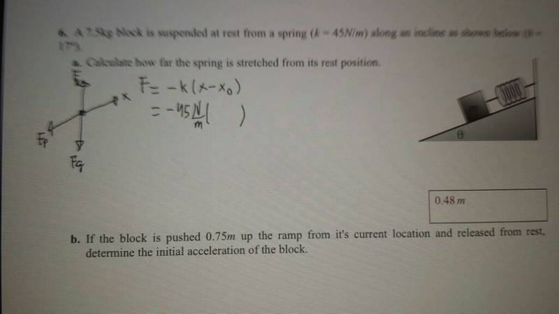

A 7.5kg block is suspended at rest from a spring (k=45N/m) along a incline as shown below (where theta= 17°)

please show your best attempt.
Well I am not sure what to do next
  • Handwritten free-body diagram of a block on an incline with forces Fg, Fs and Fp, beside a solution line F = -k(x - x0) = -45 N/m( ), and a typed answer box reading 0.48 m; a sketch of a ramp with a spring and angle theta is at right.
Start with a more careful free-body diagram for the block: what are the forces on it?
(hint: gravity, spring, and only one other...)
[edit: you appear to have Fk pointing directly upwards ... if this is the force from the spring you need to take another look at the diagram: which direction is the spring pulling on the block?
Don't know what Fp is supposed to be. Force of a "pull"? What is pulling on the black?]
Well there is force of gravity pushing down on the block and normal force pushing up than then the the force of the blocks mass is pulling the spring while the spring resists the pull...so that's what I have there in my free-body diagram
You are very confused about forces.
You listed four and there are only three - so you have one too many.
"pushing up" is too vague: the direction of the normal force is "upwards perpendicular to the ramp".
the spring force points "up along the ramp".
"gravity" is what we call the pull that something has due to it's mass.
you don't need a separate force for it. It points directly down.
redraw your free body diagram to show the correct directions and forces.
So I changed my free-body diagram. .but I still can't get the answer .48m
  • Handwritten free-body diagram, rotated sideways, showing a dot with three forces labelled Fn, Fg and Fs, plus a dashed line and text of a problem about a 7.5 kg block.
Which direction does the spring pull in?
Have you never pulled on a spring in your life?
This is a serious problem - do you not understand what a force is?
