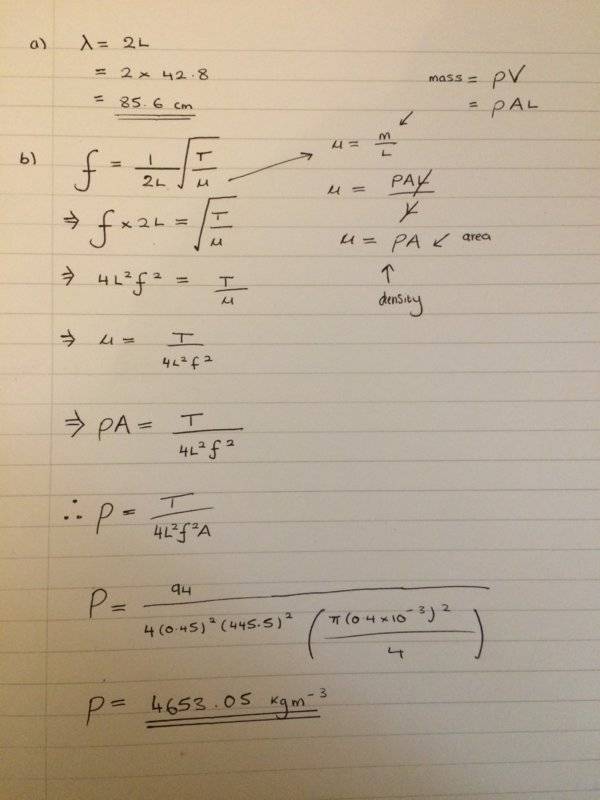

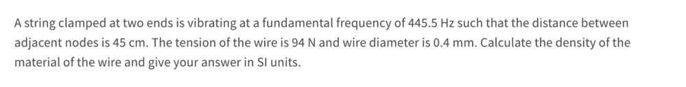

Calculate the density of the material for a vibrating string
The discussion centers on calculating the density of a material for a vibrating string. The user has attempted to solve the problem and is seeking validation for their answer. They note that mass per unit length (mu) is derived from the density multiplied by the cross-sectional area of the wire. Responses confirm that their reasoning appears sound. Overall, the calculations and understanding of the relationship between mass, density, and cross-sectional area are affirmed.

See image attached below
Frequency = 1/2L * sqrt(T/u)
Here is the question that is is given to me
Part a:
Part b:
I have given this a go and was wondering if my answer seems reasonable.
I had worked out that the mass per unit length (mu) is also the density * cross sectional area of wire
Thanks!
It looks reasonable.
Likes Bolter
