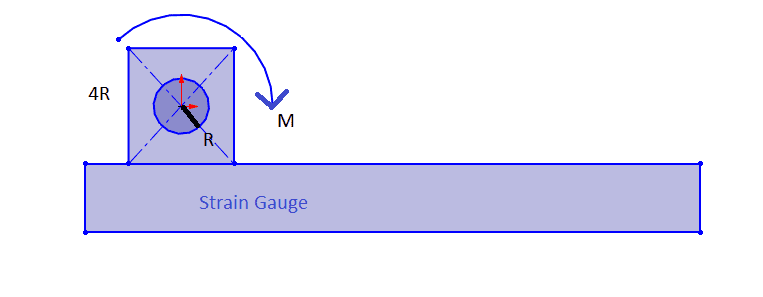

TL;DR
I have a motor sitting on a calibrated bar strain gauge. The shaft of radius R is grounded to a wall. When the motor spins, a force F is measured on the strain gauge. The motor body is coupled to a square body with sides of length 4R
How do I calculate the torque of the motor?

I assume there is a slipping clutch somewhere?
What is the strain gauge attached to, apart from the body of the motor?
Yes, it is attached as a cantilever beam, a distance D away. The strain gauge has been calibrated in this position, so we can ignore the moment caused by D.

The summary tells us the motor spins.(?)
Correction: the motor is powered, but stalled against the wall exerting its stall-torque.
We are not mind readers. Where is the point D on the diagram ?
How far is D from the axis of the motor ?
