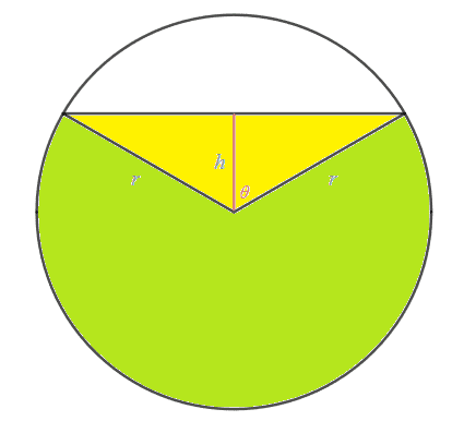

Consider the following diagram:
To find the sum of the shaded areas, I would begin by finding the angle $\theta$ in terms of $h$ and $r$. Can you do that?

You don’t need calculus. I would use MarkFL’s approach as follows.
Find the angle $\theta$ (and make sure it’s in radians). The area of the yellow triangle in Mark’s diagram is $A_1=\frac12r^2\sin2\theta$. The area of the olive-green area below it is $A_2=\frac12r^2(2\pi-2\theta)$. So the area of the water in contact with one end of the pipe is $A=A_1+A_2$. Thus:
  • The length of the major arc of the circle enclosing the olive-green area is $s=r(2\pi-2\theta)$. Hence the total surface area of water in contact with the pipe is $\boxed{2A+sL}$ where $L=240\,\mathrm{cm}$ is the length of the pipe. The answer here is in square centimetres.
  • The volume of water is $\boxed{AL}$, which is in cubic centimetres so you’ll need to convert to litres: $1\,\mathrm{cm^3}\ =\ 0.001\,\ell$.

We can do (a) without calculus or trigonometry.
Starting with MarkFL's picture we need to find the size at the top.
We can do that with Pythagoras can't we?
The triangle has hypotenuse $\frac 12\cdot 84 = 42\text{ cm}$ and vertical side $68 - \frac 12 \cdot 84 = 26\text{ cm}$ doesn't it?
(b) is a bit more complicated. I think we really need the angle $\theta$ in Mark's drawing.
Then we can find the fraction of a circle disk that corresponds to $360^\circ - 2\theta$.
And we can add the area of the two triangles, which we can find from the numbers we found in (a).
Multiply with the length of the cylinder and we have the volume.

You've got the two ends of the pipe already, and then along the pipe of length \(L\) you have:
$$r(2\pi-2\theta)L$$
