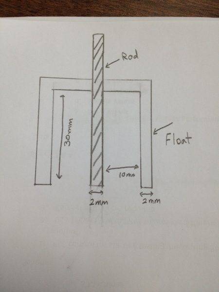

What density do I use to calculate buoyancy for a hollow cylinder float?

mido
I have a hollow cylinder float as seen attached, trying to work out the buoyancy. I work out the inner volume for the cylinder, but do I use air density or cylinder density ?
What is the fluid it will be immersed in? If it is air, then you should use air density ρ=1.225kg/m3 at 15° to 20°C at sea level.
Buoyancy depends on the density of the fluid and the volume of the object,
FBfluidVobjectg
As Archimedes is reputed to have said: "the weight of the displaced fluid"
it will be immersed in water, it is a hollow cylinder with air trapped in
The solution to this depends upon how accurate you need the answer. The air/water interface at the bottom is under pressure ρgh and the volume will be less than the cylinder volume, so the upthrust will be less. You may need to account for the volume of air being under water pressure of around 0.3m depth (about 1/30 atmospheric pressure) - which means that the original volume of air will be compressed additionally by about 3% (back of a fag packet calculation). Is that relevant for you? A more accurate answer can be obtained if you are bothered about greater accuracy than a percent.
Otherwise you can say the upthrust will be the volume of the cylinder times the density of water. (minus the actual weight of the material of the cylinder, of course.)
that is correct, but i don't think he would want to go for THAT accuracy, involving the extra compression of air by 3%. He could simply obtain the volume, plug in the value of ρwater= 1000kg/m3 along with g=9.8m/s2 and voila.
ALTHOUGH yes, i don't think the upthrust would be enough to keep the cylinder afloat
It would all depend upon how far under the cylinder would go. on that vertical rod. and the mass of the cylinder. My lungs collapse enough to make me neutral at less than 3m depth.
AS with all Engineering matters, the Numbers Count.
