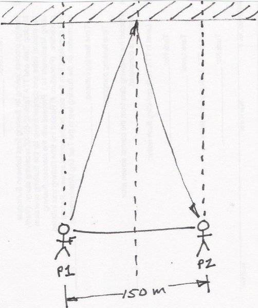

The human beings are standing at equal distances from a big and high wall. Distance between them is 150 m. When one fires the gun the other hears two shots in an interval of 2 seconds, using the speed of sound to be 340.298 m/s calculate their distance to the wall.
V=x/t
I don't know what two shots mean, i thought it means the sound is reflected from the wall, so i calculated time to reach girl 2 to girl 1 to be 0.44s subtractes from 2s and got 1.55s. Taking the time from guy1 to wall and wall to guy2 to be 1.55/2 i calculated distance to be 260m but that's not even close. What is wrong?

A propagating wave, like sound, will reach its receiver in the shortest possible time (at constant velocity, this is also the shortest distance). The first sound is the sound traveling straight between the men. The second sound that echoes off the wall will first be heard after traveling the shortest possible distance between the men which includes bouncing off the wall. This shortest distance is bouncing off the wall at a point midway between the men, just as if one man threw a tennis ball to the other by bouncing it off the wall. Think of a beam of light reflecting off a mirror.
Could you perhaps make some sorth of a drawing or a picture on how this represents the problem?
Try this.

It appears that the answer book i have says its 406, while the paper i got says 412. I guess someone done it wrong on paper, but the book must be correct so its 406. When i do the midpoint thing i get the equation V=x-75 and y being the shortest distance to wall is (x^2-75^2)^1/2 which gives me approximately 408.9.
I get 408.46 m but your answer is probably okay due to some rounding. Unless I've missed something I guess the answer book is incorrect.
