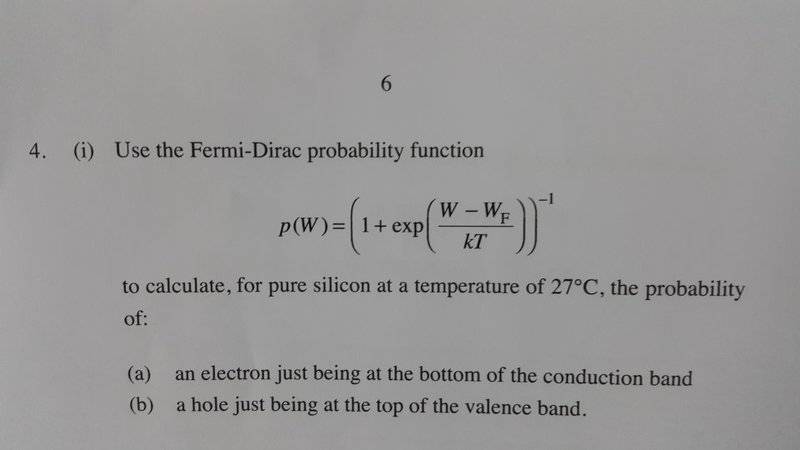

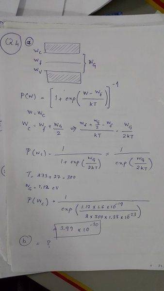

Hi dear friends
Please reffer to my work , I did part ( a )
only
Could you please help me to do part ( b )
I don't know how to do it.

(a) is correct.
(b): If p is the fraction of electrons in the conduction band (at energy EG/2) & coming from the valence band, what would be the fraction of holes left behind in the valence band, seeing as those electrons came from the top of the valence band?
Hint: no electrons going to the conduction band ⇒no missing holes!

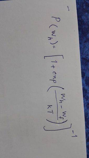

Then the equation may change to the below
I guess. .
If this is correct then we have to write an equation for W h in term of Wg and Wf to eliminate Wf.
What will be that equation?

OK, after a bit more perusal on my part:
My textbook gives the probability distribution for holes as not W(p) as it is for electrons, but as 1 - W(p). Without a believable rationale, but I'm sure it's correct, because later on they use that expression for deriving the totality of free carriers for electrons and for holes and get roughly the same number for each, which has to be correct. That was supposed to be my hint in post 2 but as I say it wasn't based on good argument.
So, bottom line, if you use 1 - W(p) for the holes, and use Wv in lieu of Wc, and proceedig exactly as you did in part (a), you will get your answer. Do that and let us know what you come up with.
