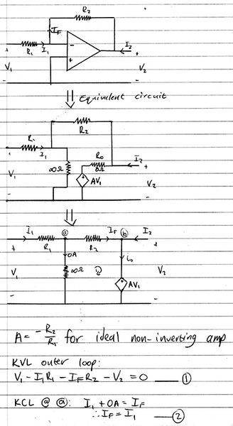

Hi guys :smile: This question has been bugging me for a REALLY long time so thanks in advance for the help :biggrin:!
Calculate the Hybrid Parameters for an inverting op amp shown below:
https://www.dropbox.com/s/45mjldud2ar5pwg/invOpAmp.jpg
And I need to get it into the form of:
https://www.dropbox.com/s/5vto0ipwtbre7qk/hequiv.jpg
[itex]V_1 = aI_1 + bV_2[/itex]
and
[itex]I_2 = cI_1 + dV_2[/itex]
I tried doing it like this:
https://www.dropbox.com/s/9gnpycdi3p6g1ys/p1.jpg
https://www.dropbox.com/s/5u7f3109u1i8zoa/p2.jpg
But I got stuck trying to get [itex]I_2[/itex], [itex]I_1[/itex] and [itex]V_2[/itex] all in the same equation.
So I redrew the equivalent model to see if maybe there was another loop I could use:
https://www.dropbox.com/s/p23mwsbjdmmpbex/p3.jpg
Which lead to the exact same result :frown:
So at the moment I'm thinking maybe it isn't possible to get the second equation?
Here the calculations are if they don't load:
Handwritten working on lined paper: an inverting op amp circuit with feedback resistor R2, input resistor R1, and currents I1, IF, I2, followed by KCL and KVL equations and a second sketch of the circuit with loop equations.
Handwritten derivation: 'Now KCL @ b yields' followed by I_F + I_2 + i_o = 0, so i_o = -I_F - I_2. Below, 'KVL inner loop' gives V_2 = -(R_2/R_1) V_1 and V_2 = -(R_2/R_1)(I_1 R_1).
Handwritten circuit analysis: an inverting op amp schematic, an equivalent circuit with a dependent voltage source AV1, and a simplified node diagram with KVL and KCL equations and gain A = -R2/R1.

The h21 parameter is the ratio of the output current (with the output shorted to ground) to the input current. If the opamp is taken to be ideal with zero output impedance, then the output current into a short will be infinite for any non-zero input current, and hence, h21 would be "∞".
The parameter h11 is the input impedance with the output shorted. We can see by inspection that it would be R1+R2.
The h12 parameter is the reverse voltage transfer ratio with the input open circuited. To determine this, we apply a voltage to the output and take the ratio of that voltage to the voltage that would appear at the input; it would be "1". The opamp would fight the application of a test voltage to its output, but that's the definition of h12.
Finally, the h22 parameter is the output conductance with the input open circuited. Since an ideal opamp has zero output impedance, h22 will be "∞".
Using h parameters with this circuit wouldn't be appropriate if the opamp is ideal. I would assume a small output impedance (call it Ro); then h21 and h22 wouldn't be "∞", and you wouldn't have the fighting voltage source problem when applying the test voltage to the output to determine h12.

I originally had [itex]R_o[/itex] in my calculations but since the op amp is ideal I had to make it equal to zero :smile: With [itex]R_o[/itex] in the mix I did have another loop but my problem there was that I was introducing a variable that was not given in the question so I'd have to try to get it in terms of [itex]I_1[/itex], [itex]V_1[/itex], [itex]I_2[/itex] or [itex]V_2[/itex] which also didn't seem practical. Since having an [itex]R_o[/itex] that isn't zero implies that the op amp isn't ideal I decided I'd have to try another route!
It was never stated in the question that it was possible to get a working solution, so I can argue that it is, in fact, impossible using an ideal op amp :biggrin:
Your explanation makes perfect sense, thank you very much for your time and effort :smile:!
