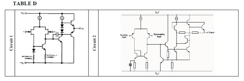

d) TABLE D shows the internal circuitry of two op-amps. Identify, with justification, which op-amp circuit is most likely to belong to which op-amp in TABLE A.
Well, what can you say about the two circuits? No numbers, but I notice two obvious features that are mentioned in the descriptions in Table A.

d)
Circuit 1 has a FET input stage so as in part b it will have a high input resistance making it op-amp B
I am still unsure on this part.
Circuit 2 has a BJT inputhavein a low input resistance making it fit with the specifications of op-amp A

I agree with a,b & d.
