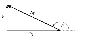

A 0.14 kg baseball moves horizontally with a speed of 29 m/s toward a bat. After striking the bat the ball moves vertically upward with 46% of its initial speed. Find the direction and magnitude of the impulse delivered to the ball by the bat.
Find the ° (measured from the initial direction of the ball)
Find the kg·m/s
J = ΔP, Pf=Pi, P=mv
I have the initial momentum as 4.06 kgm/s, and that is just the momentum of the baseball. Or would I put initial momentum as 0? I think it would be the 4.06 because at the beginning of the problem the baseball is moving. The momentum of the baseball after the hit is 1.86 kgm/s, which I got by multiplying the 46% by the mass of the baseball, giving me 13.34 m/s and then multiplying that by .14kg giving me 1.86 kgm/s. I'm unsure how to proceed from here.
Impulse J is the change in momentum (mv_final - mv_initial). You have to vectorially subtract them. Familiar with vector addition and subtraction?
Yupp. So I put the x vector as 29 and the y vector as 13.34 which gave me a hypotenuse of 31.92, then I figured out theta to be 24.7 by doing the arc tangent of 13.34/29 which I put as the direction of the impulse but it is telling me that it is wrong. What did I screw up?
Make a sketch and determine which quadrant the angle should be in. arctan is insensitive to the placement of signs in its argument (it can't tell if a negative argument came from the numerator or denominator of the values comprising the argument). A better function is the atan2 function which takes two arguments, the y and the x (or the "rise" and the "run"), and always returns an unambiguous result.

Supposing the initial momentum is directed along the +x axis, and the final momentum directed along the +y axis, then:
I got 335 for that angle, but it's still wrong. This is the only problem on the assignment that I had any trouble with. Very frustrating

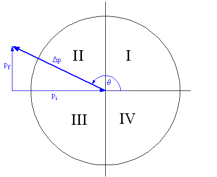

What quadrant is the angle in? What is the range of angles for that quadrant?
1st quadrant and 0-90
Which quadrant?
gneill said:
Which quadrant?
Oh for some reason I was thinking it was starting from the other side. I got it now, thank you so much!
