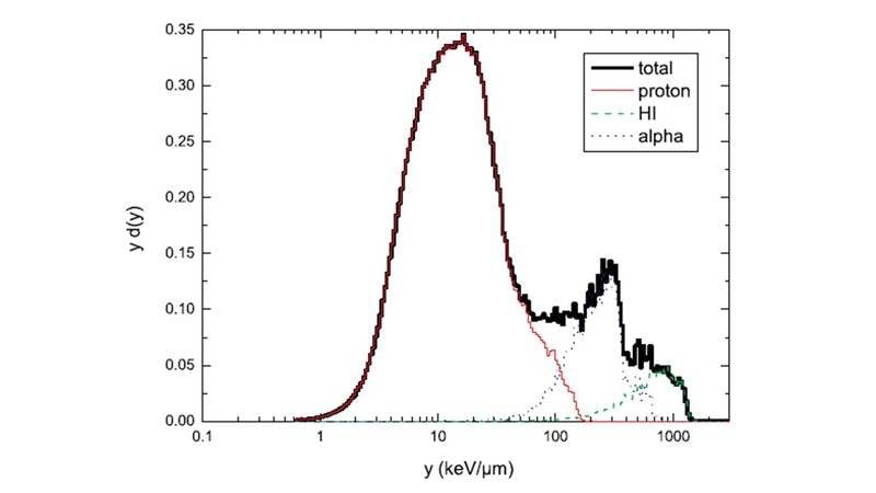

For a TEPC irradiated with neutrons you must calculated the energy deposition of all secondary charged particules: protons, alpha, heavy ions and possibly deuterons, tritons. Electrons and photons can be neglected. For neutrons of 14 MeV a lineal energy of 10 keV/µm gives the maximum of the microdosimetric spectrum in y(dy) but for protons not photons!
In MCNP The lineal energy distribution for each secondary heavy charged particle is estimated using a F6 tally type for energy deposit coupled to a pulse height tally F8 for each heavy charged particle specie.
it is explain in this publication :
https://www.sciencedirect.com/science/article/abs/pii/S1350448719304755?via=ihub
You have a full example in § 1.VII of this referrence:
https://www.researchgate.net/public...lems_from_analytical_to_monte-carlo_solutions
for example a calculation with MCNP for 14 MeV neutrons gives (from Antoni et Bourgois radiation measurements vol. 128, spet 2019, 106189):
good luck

The lineal energy distribution for each secondary heavy charged particle is estimated using a F6 tally type for energy deposit coupled to a pulse height tally F8 for each heavy charged particle specie. An anticoincidence pulse height card, i.e., “ft8 phl”, is added to the F8 tally for counting single-event of energy imparted in gas arising from specific nuclear reaction in the cavity wall. For example, the following instructions are set to determine the occurrence number of reaction in the gas. For setting up this card, 185 logarithmic lineal energy bins are defined to ensure about 50 equal subdivisions per decade between 0.6 and 3030 keV/μm−1. In the command lines hereafter, this card provides the lineal energy spectrum for
all charged particles:
F6:h,a,# 10 $ 10 is cell of the internal cavity
F8:N 10
E8 0 1.39E-11 0.0004 183LOG 2.02
FT8 PHL 1 66 1 0 $ for He-3 and gas is material 1
after that you must calculate y (y=e/l with l the the mean chord of your detector)
and yd(y)
there are some adjustments to take into account for the MCNP parameters, for that please read the publications I cited.

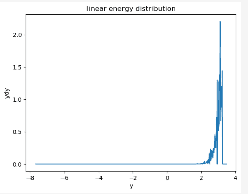

Thank you very much for your patient explanation. I believe I have a clearer understanding of microdosimetry in MCNP now. However, when it comes to calculating alpha particles, I excluded heavy ions from the simulation. I obtained a record of alpha counts, and I wonder if this approach is appropriate?
Regarding the F8 output, I processed it using the code below. However, the results differ from the reference literature, which is the one you attached in your initial response.
I'm not sure if there is an issue with my post-processing. Specifically, I considered the first column as deposited energy and the second column as pulse, f(y), for subsequent calculations. I have attached the detailed code and would appreciate it if you could take a look. Your assistance would be immensely helpful. thank you again!

can you give your mcnp input file ?
you must change your importance (you have imp:n,e=1) put in block 3 :
imp:n 1 1 1 0
imp:h,a 1 1 0 0
The 7th parameter of the “phys:n” card and “phys:p” is set to 1 to ensure the generation and transport of recoil and (n,p) protons as well as recoil heavy ions :
PHYS:N 20 20 0 J J J 1 -1 J J J 0 0 $ 7th entry set to 1
PHYS;h 20 20 -1 J 0 J 1 J J J 0 0 0 0.917
you can calculated H and A once:
C PROTON Energy Deposition
F6:h 1
F8:N 1
FT8 PHL 1 6 1 0
C ALPHA Energy Deposition
F26:A 1
F28:N 1
E28 0 1.39E-11 0.0004 183LOG 2.02
FT28 PHL 1 26 1 0
and the density of gas is too high it must be 7.77e-5 instead of 1.85
and it must be ok

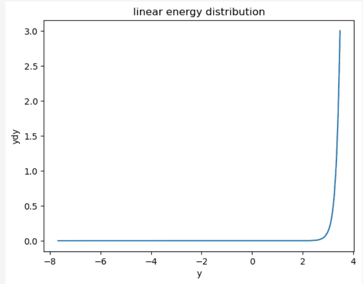

Thank you very much for your guidance. it has been immensely helpful to me.The gas density is 0.000185,I writen wrong. now I change it to 7.77e-5.However, I noticed a small difference. When plotting the yfy/ydy graphs for alpha particles based on my previous code, I observed that the y-ydy plot has a maximum y-axis value of 2(below figure). According to the reference to the 13.9 MeV article you mentioned earlier, it should be around 0.1. I am unsure if there is an issue here. Upon normalizing, I found that the y-axis for alpha particles becomes 0.1, but after normalization for protons, it becomes 0.035. I am not sure if there is something wrong or if there are specific considerations to be taken into account. I have attached the modified MCNP input file and processing code. I express my gratitude again.
processing code:

I don't know your processing code, can you give your output file I will try with my processing code (Excel :-))
I think your curve is for alpha, can your try with protons and alpha+ protons ?
yes,this is alpha and I have also processed protons, but they do not match.I have placed the output file in the attachment.
Thank you very much!
with your file and my processing it gives:
not so bad! Some convergence problem (with more nps it will be ok)
Thank you very much.
This indicates that there is no issue with the simulation code, but there might be an error in the processing code. I exported tally8/tally28 to a txt file and used the above code for processing. I'm unsure where the problem lies.
