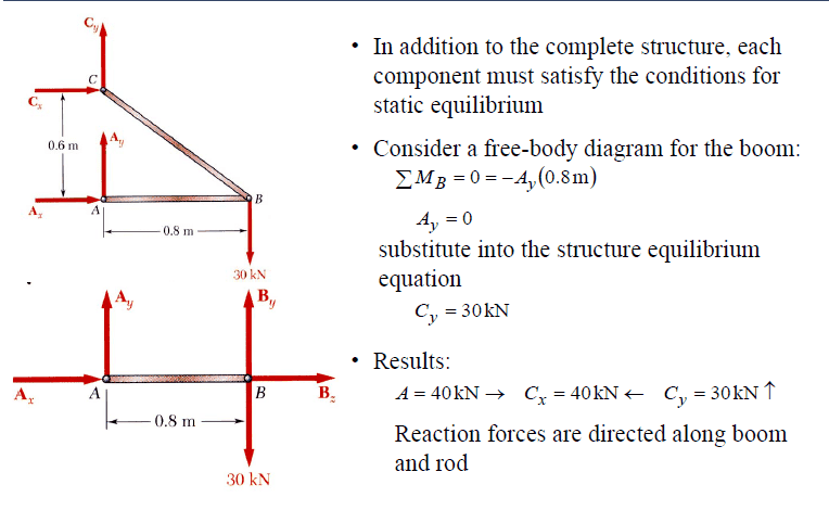

For the moment about B , Cy(0.8) +Ay(0.8) + Cx(0.6) = 0 , right ?
Why the author only give ,-Ay(0.8) = 0
Is it wrong ?

because the moment Cy(0.8) +Ay(0.8) can cause the member to turn about B , right ?
Cy and Cx don't act on the boom so don't appear in the fbd for that member.

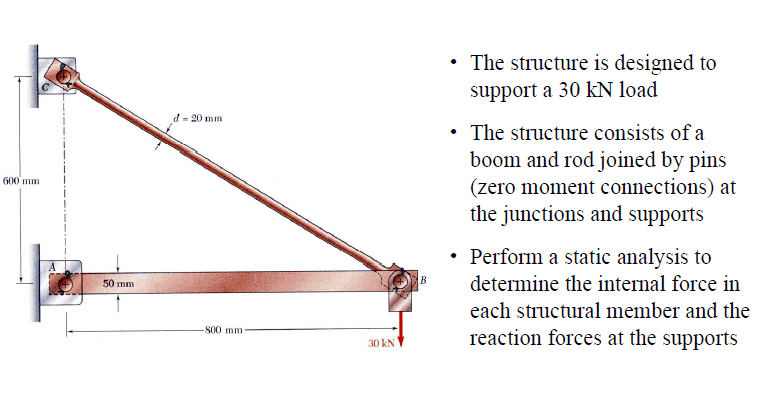

What do you mean by boom?
Read your first attachment.
The fbd for the boom appears at the bottom of your 3rd attachment.

OK, saw it.. Why they don't act on the 'boom' ?
Because point C isn't part of the boom.
would the forces you apply to your keyboard appear in a free body diagram of your neighbours kitchen sink?
A fbd of the boom should include only the forces acting on the boom. Those are the forces at A and B.

Then, why is point C given in the problem?
The rod starts at C and ends at B.
The boom starts at A and ends at B.
Call them member BC and member AB if you prefer.

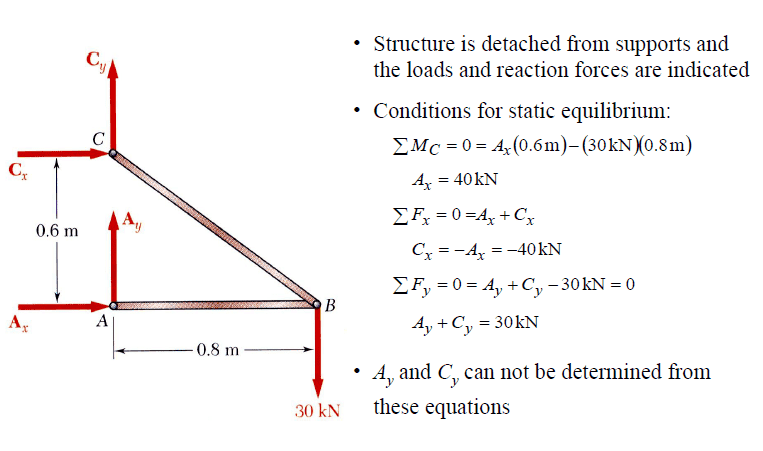

We need to consider moment at C due to all members in the problem, right? So, we need to consider the forces at C, right?
Your second attachment takes moments about C for the entire structure.
The question asks you to find the reaction forces, so yeah, we need to consider the forces at C, and find them.

No, I am asking why for moment about B, ' we don't have to consider force Cx and Cy??
You'll have to be more specific.
The worked solution takes moments about B for the boom only.
Cx and Cy don't act on the boom so are not included in the free body diagram for the boom and so are not included in any subsequent equilibrium equations.
If we were to take moments about B for the rod, or for the entire structure then Cx and Cy would be relevant.

ok , why we have to consider 1 'boom' only during calculation of moment about B ?? for moment about C , we consider 2 boom , right ? That's why the Ax(0.6) and -30(0.8)
It's just the way the author choose to do it.
It's a quick way to show Ay is zero.
It could be done in literally infinite different ways, we can take moments about any point in space for any or all static members and the answer is always zero. The trick is to find the most convenient point to make the math quick and easy.

So, this is the special case? If not, then my moment about B , Cy(0.8) +Ay(0.8) + Cx(0.6) = 0 would be correct?
So, the author purposely make Ay = 0?

Your equation is correct, and can be used to solve the question.
Why not try to solve it your way and see what happens?
Is your way or the authors way faster?
Hopefully you can now see why the author did what he or she did. It comes down to my earlier comment:

I still don't understand why the author choose to take moment about C at one boom only...
Because it's the fastest way to find Ay.

i will end up getting Cy(0.8) +Ay(0.8) + Cx(0.6) = 0
Cy(0.8) +Ay(0.8) -40(0.6) = 0 , where Cy = Ay = 15N ?
Which is not same with the author where Ay = 0 ...Is it wrong ?

Something went wrong with your algebra.
Show all your working.
I've had another look and taking moments about B for the entire structure offers no new information, all it says is that Ay + Cy = 30, which we already know from the vertical forces equilibrium equation. I apologise for saying it could be used to find Ay!
The question can't be solved without doing a fbd of either one of the rod or boom. We can take moments about B for the rod to find Cy but is faster to do what the author did.

So, my moment about B = Cy(0.8) +Ay(0.8)
+ Cx(0.6) = 0
is wrong? Or it's not suitable to solve this question ?

It's right.
Your subsequent working must have had an error as your conclusion was incorrect.
Why not try again, be more careful with your algebra and see how far you get.
