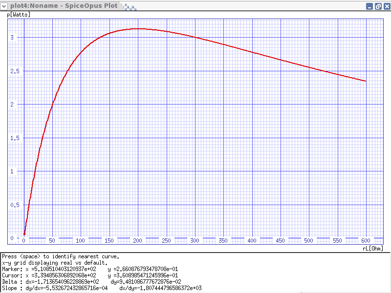

The decrease in current caused by increasing the resistance is what drives the power. Graphing (for a 120V power outlet), you get these logrithmic amperage and power curves:
Russ just reminded me that I forgot to post that graph about power dissipation as it related to an internal source resistance.
This demonstrates what I was talking about earlier about maximum power transfer from [non-ideal] source to load. Maximum power transfer will happen when the load resistance is equal to the internal source resistance or thevenin resistance.

The internal source has a resistance of 200ohms. The load is varied in steps of one from 1ohm to 600ohms. Note from the graph how max. power transfer occurs when the load is 200ohms.

Good thinking - yes, there can be no situation where the power source has zero internal resistance, so at low resistance for the load, the internal resistance of the source plays a big role.
