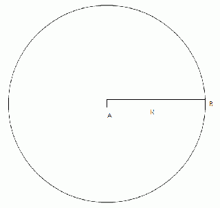

Hello to everyone,
I am trying to calculate how much physical force is needed at point B (imagine a person pushing on a bar attached to point A) to generate 100 kw per hour where the radius is 50 meter. If you imagine that at point A there is a system of gears attached to an alternator/generator which transforms 1 rpm from point B into 3600 rpm at point A(4 gears with a gear ration of 15:1 between them), how much force would be needed to generate 100 kilowatts per hour? I understand there will be friction, but at the moment i am just trying conceptualize how much physical work is needed to generate that amount of power.
This is the first time i am trying something like this so if i have made any wrong assumptions, please correct me.

You need to give us more information.
Power is work done per unit time. So 100 KW is 100 KJ per second = 100,000 Nm/sec.
In order to determine how much force is required to generate such power, you have to tell us how fast you want to make the bar rotate. For example, if you want to generate 100 KW at a rotation rate of 1 revolution/second (ie. B moves 2∏R = 314 m. in one second) then you would need a force of 100,000/314 = 318 N.

Thank you Andrew. you raise a very good question:
[1] i am not sure weather to generate 60 kilowatts per hour ( i am simplifying the numbers so i can understand easier but my actual project is for 100 kilowatts per hour ), if one needs to generate 60 kw per second or 1 kw per minute?
[2] Also, the way i visualize it in my mind, is that a person will have to be applying 318 Newtons per meter for 314 meters to make 1 revolution. is this correct? if so, do i use the 60kw/sec or 1kw/min to calculate the force i would need.
You are confusing yourself by talking about "kilowatts/sec" and "kilowatts/min"; those terms make no more sense than something like "miles per hour per day". Power, measured in watts, is not an amount of work but the rate at which that work is delivered: one Joule of work per second is one watt.
Your problem is asking for 100 kw, meaning that it will deliver 100,000 Joules/sec for as long as it is operating, and it will take some force in Newtons to do this. Obviously the longer it operates the more total joules it will deliver, but the force in Newtons will be the same; it'll just be operating for a longer time.
Thank you Nugatory. I think i really am confusing myself more. let me explain what it is i want to do. i have an oven that is rated at 100 kWh and it need to run for 3 hours. I am trying to determine how much force would be needed to provide 100 kWh to that oven using the set-up i mentioned in my first post ( 4 gears with 15:1 gear ratio attached to a bar with the length of 50 m ).
Clearly i cannot do 314 m in 1 second :smile: so i was thinking what if i added more gears so that instead of providing the 318 N force per 1 revolution of point B, i provide it over 1/60 of that one revolution. Therefore :
3600 rpm * 60 = 216000 rpm . If i used 6 gears with ratio of 15:1 between 5 of them and 5:1 between 1 of them making it a total of 253125:1 and then proceeded to make 1 revolution from point , will i be providing the same power every second of that revolution? I know i cannot do 314 meters in 1 minute either lol but am i thinking about this the right way? or is there another way to spread that much force and still provide 100 kw/s?

You're still confusing power (watts) and energy (joules) here. 100 kWh is a measure of energy. It's the amount of energy a 100 kw power source delivers in one hour, or a 10 kW source delivers in 10 hours, or a 1 kW source delivers in 100 hours. If you remember that there are 3600 seconds in an hour, and one watt is one joule per second, you'll see that all of the above combinations come out to the same amount of energy, 3.6x108 joules, whether it's a little power delivered over a long time or a lot of power delivered over a short time.
(100 kW is also a LOT of power... It's about 130 horsepower, and I suspect that you're misreading the specs of your oven).
Yes, you're thinking about it the right way now: as long as you're maintaining a constant speed and force you're delivering a constant power. But notice that this doesn't change if you play with the gearing or the length of the lever arm; all that does is make it so you're applying the same force over a different distance and (because your speed is constant) a different time, so applying the same amount of power for a longer time and doing more total work.
You're also quite right that you can't do 314 meters in one second - as I said above, 100 kW is a lot of power.

Just for info... What will be applying force on the bar?
i believe a fit human can generate about 1/3rd of a horsepower (eg 250W) for sustained periods. If you need 100kW that's quite a team of people you will need (400 people).

Jaxodus;
From just a mechanical perspective. A 50 meter lever seems somewhat excessive. And your discussion of running an oven, and then running a cell phone with a 1kw AA battery does not add to the clarity at all. Besides it would be more instructive if you first told us about the generator, and the rating of same. Irregardless of the gears and the lever used to drive the generator, the power availability would depend on the capabilities of the generator itself. Whether or not the lever and gears can deliver the necessary torque to the generator does not depend on the weather. Sorry, as I have been taken to task for my language and use of same, I may as well make my own observations. Nothing personal!
Thank you jeffery. and please do not hesitate to point out any wrong assumptions i have made (as i said in my first post ). this will be my first attempt at anything like this and i would like to get it right. and to clarify, the project is for 100 kw-second ( thank you willem2 for clarifying this ) but i gave the example of the cell phone just for sophie. i know there is no 1kw AA battery lol
This is the item i had in mind to attach the gear to at point A ( diagram in the first post ). only instead of using fuel, i wanted to calculate the force required to do it manually:

I was thinking of having 4 arms/levers attached to point A in such a manner that they form a plus sign. then i can have 50 people per arm. Infact, as the discussions have progressed, something else comes to mind. what if the 250w per person was directed to raise an object which was 5000 kg / m3, such as hematite ( iron ore which is 5095 kg/m3 ) and had 10 m3 of it raised to 100 meters ( it does not strictly have to be raised above ground, it could just as well be pulled up from a shaft dug 100m into the ground. This is the calculation i made. please tell me if it is wrong:
10 m3 blocks of hematite ( 1 on top of another ) = 50000 kg m3
(so 50000 (weight) * .028 m/s (to allow the blocks to fall in 1 hour as 100 meter / 3600 seconds ) * 100 (height)) / 1000 (to convert it into kw ) = 140 kw-s.
Is this correct? using this, for one hour i would be getting 140 kw-s for every second the weight falls?

my understanding is that, if i increase the length of the lever to 100 meters, i would have not have to use the same force but only work longer. honestly, as long as i get 300 kwh to discharge every 24 hours, i do not care if it takes 8 hours to get this done.
