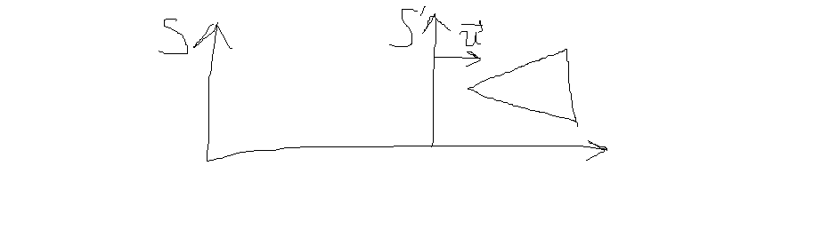

End what about this case? Will observer in S will see triangle?
LagrangeEuler said:
And what about this case? Will observer in S will see triangle?
Yes, but...
We need to be careful about using the word "see" here. When we say that we "see" an object, we're actually seeing the image on the retina of our eyes (or the pixel array of a digital camera, or a sheet of photographic film if we're using an old-fashioned camera) formed by light reflected from the object. Different parts of the object are different distances from the eye so the light that forms the image left different parts of the object at different times; for a fast moving object the image we see won't be an accurate representation of the entire object at anyone moment.
Thus, to observe length contraction, we have to calculate where the various parts of the object are at the same time. In principle we would fill all of space with tiny observers, all at rest relative to us and holding synchronized clocks and pieces of paper. At exactly the stroke of midnight they all write down whether a piece of the triangle is passing by them just then; afterwards, we gather up the pieces of paper and use them to reconstruct exactly where the triangle was at the stroke of midnight. When people talk about "seeing" that the triange is length-contracted, that's usually what they mean, and that's what I meant when I answered "yes" above.
The triangle will still be an isoceles triangle, but because it is length-contracted along the direction of travel, the angle at the apex will be greater and the two base angles will be correspondingly smaller.
