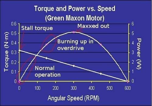

xiv_wolf said:
Is the RPM of the motor considered?
Oh yeah, that's important. If you overload it to the stall torque(power) of the motor, that will stop it completely. The motor will just sit still and draw a huge current.
ETA:
I was sitting here at work and starting wondering if I gave a good answer. I really didn't.
Here is an ideal speed-torque curve for a DC motor. It shows the speed, torque, and power relationship.
I got it from this http://lancet.mit.edu/motors/motors3.html" and added some annotations.
Note the regions that I marked. DC motors do have a theoretical limit on how much power they can throughput. The range for normal operation will end long before that.
