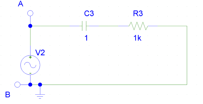

It's true, however I had a lab where I needed to identify an unknown circuit. One of the possible circuits given was a capacitor by itself and I needed to explain why it could not have been a single capacitor as there was phase shift present.

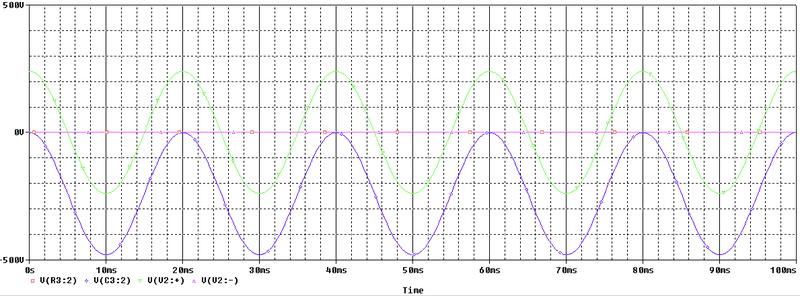

I just simulated something in pSpice as well, out of curiosity, does the phase difference only happen if the resistor is before the capacitor in the circuit? When I tested it in pSpice a circuit with a resistor after the capacitor had no difference in phase compared to the source.
Why would there be a difference between source and capacitor if there were no resistor in between?
MAybe you should rely on the logic of the circuit in itself rather than on a simulation which may not be doing what you think it's doing?
Simulations are great for complex circuit analysis (no-one would bother to do a complex circuit by hand these days) but, for one or two components, does it really help?
But what is the phase that you are calculating? is it between two voltages of a voltage and a current. If you give the information here that you gave spice, then it would be more clear.
Voltage source:
Voff: 0
Vamp: 240
Freq: 50
TD: 0
TR: 0
Phase: 90
Traces here:

Is that capacitor 1 Farad? If so, you won't get much of a phase shift.
Try 1 μF.
Measure from ground to a point between the resistor and the capacitor. You should get a clear phase shift compared with the input voltage.
Thanks, I tried that, you're absolutely right. It did cause a phase shift. It was confusing me quite a bit how I could have gotten those results.
