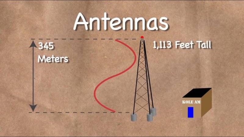

A while ago, I saw an explanation of radio waves. Overall, it's a decent vid. I bumped into some nasty problems.
Basically, the image shows that the wavelength of a EM-wave corresponds to the height of the antenna. The visualisation however can't be right since the wave cannot go upwards- the wave's path is oriented 90 degrees to the antenna. So... How.. How the heck should I combine these statements?!
It just keeps bugging me to figure out the right image of a EM wave cause it's extremely counter intuitive and I can't find anything on the net.

Do you have the link for this video? The wave that they are depicting, is the standing wave inside the antenna. This will induce an oscillating wave of changing electric and magnetic fields in space (outside the antenna). Not all antennas are full wave. Some are half-wave or quarter wave. You may find the following guide, useful. http://www.phy.davidson.edu/instrum...opagation Transmission Lines and Antennas.pdf

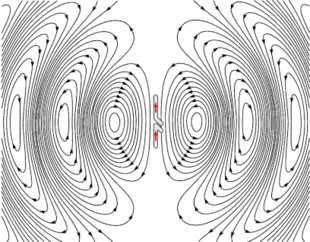

From wikipedia's article on radio antennas:
This represents a slice of the E and B fields emanating from a dipole antenna. Rotate the E field by 180 degrees about the vertical axis of the antenna so that it forms a spherical shape and you'll have an idea of what the expanding wavefront looks like. The next image shows how the wavefront propagates over time (hopefully it animates correctly).
The orientation of the EM waves (polarization) is vertical in this case, as the field lines are vertically oriented.
and that is what they are showing you ... that antenna happens to be a wavelength long
it is NOT showing your the radiation pattern from the antenna
@Drakkith 's post has a really good animation for that
well waves can go up if the antenna is a horizontal one and not a vertical one :smile:
But again ... refer to my first comment
I notice that the polarisation is not entirely vertical in your diagram. At the top and bottom of your loops the arrows point radially towards or away from the source. How does this work for a transverse wave?

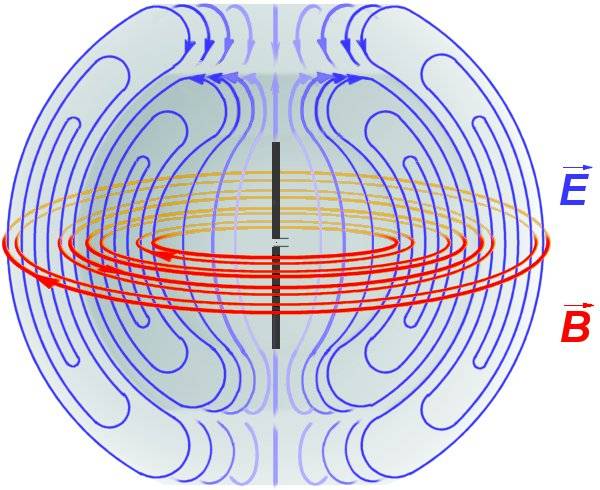

The most simple harmonic solution of the free Maxwell equations is the Hertzian dipole radiation. The vector potential is given by
$$\vec{A}(t,\vec{x})=-\frac{\mathrm{i} \omega}{4 \pi r c} \vec{p} \exp \left [\frac{\mathrm{i} \omega}{c} (r-c t) \right].$$
Then you get
$$\vec{B}=\vec{\nabla} \times \vec{A}, \quad \vec{E}=\frac{\mathrm{i} c}{\omega} \vec{\nabla} \times \vec{B}.$$
You'll see that both the electric and magnetic field are transverse, i.e., ##\vec{\nabla} \cdot \vec{E}=\vec{\nabla} \cdot \vec{B}=0##.
Note that it is not a plane but a spherical wave! Only in the far-field region, i.e., ##r \gg \lambda##, the fields are locally nearly plane waves moving radially out from the place of the dipole, and indeed in this region ##\vec{x} \cdot \vec{E}=\vec{x} \cdot \vec{B} \simeq 0##.
At least qualitatively the field looks like shown in #4.
True, but the amplitude of the wave at this angle is extremely low. Most of the energy of the wave lies closer to the horizontal and a receiver oriented such that it responds maximally to vertically polarized EM waves (such as an identical antenna to the transmitter) would show the highest amplitude when oriented vertically. Twisting it 90 degrees would cause the receiver to read nearly zero amplitude.
Technically I suppose calling the wave "vertically polarized" assumes the receiver is placed near to the horizontal and is in reference to the Earth's surface. A satellite receiving a signal would be free to call its polarization anything it wants since there is no horizontal or vertical in space.
